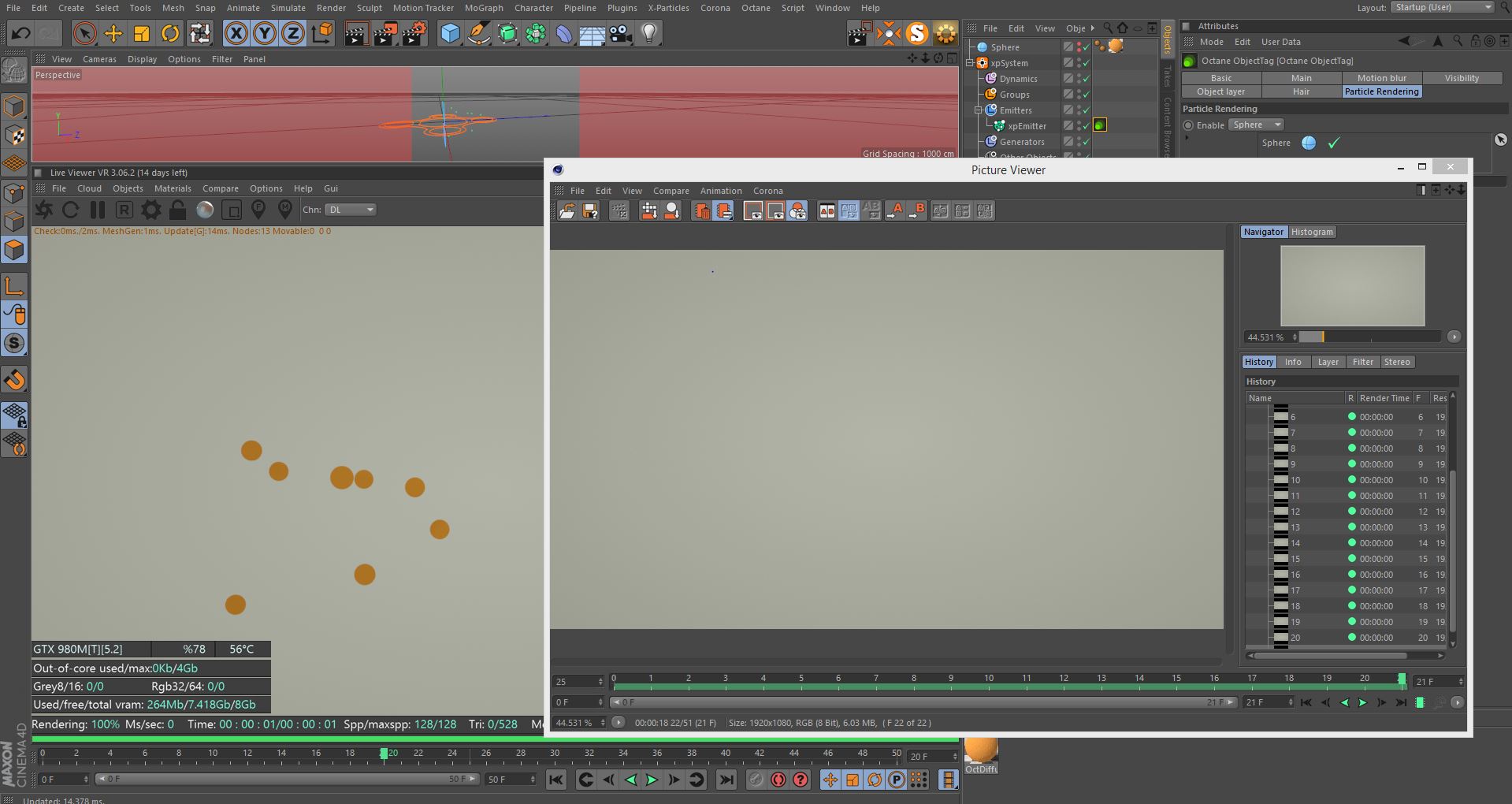

When I use an Octane tag with X-Particles and set it to render sphere it appears in live viewer but not render.
Any idea why?

My guess is that the sphere in the hierarchy has the two red lights indicating it is hidden from both viewport and render. Try unchecking those lights, and moving the sphere out of view of the camera if it is in the way.

If 'perfect sphere' is checked in attributes of sphere object, uncheck it. Octane is unable to render perfect sphere in PV.

Thanks for the suggestions guys but neither of those worked unfortunately.
Scene attached for reference.

I don't understand what's the problem with your file. For me it works fine, i have orange spheres in the PV. I've just pushed render in PV...

Ugh, no idea what's going on. Tried a different object, re-installed C4D and even updated Nvidia drivers but still not showing up in PV/render.
I'm stumped!
