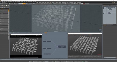

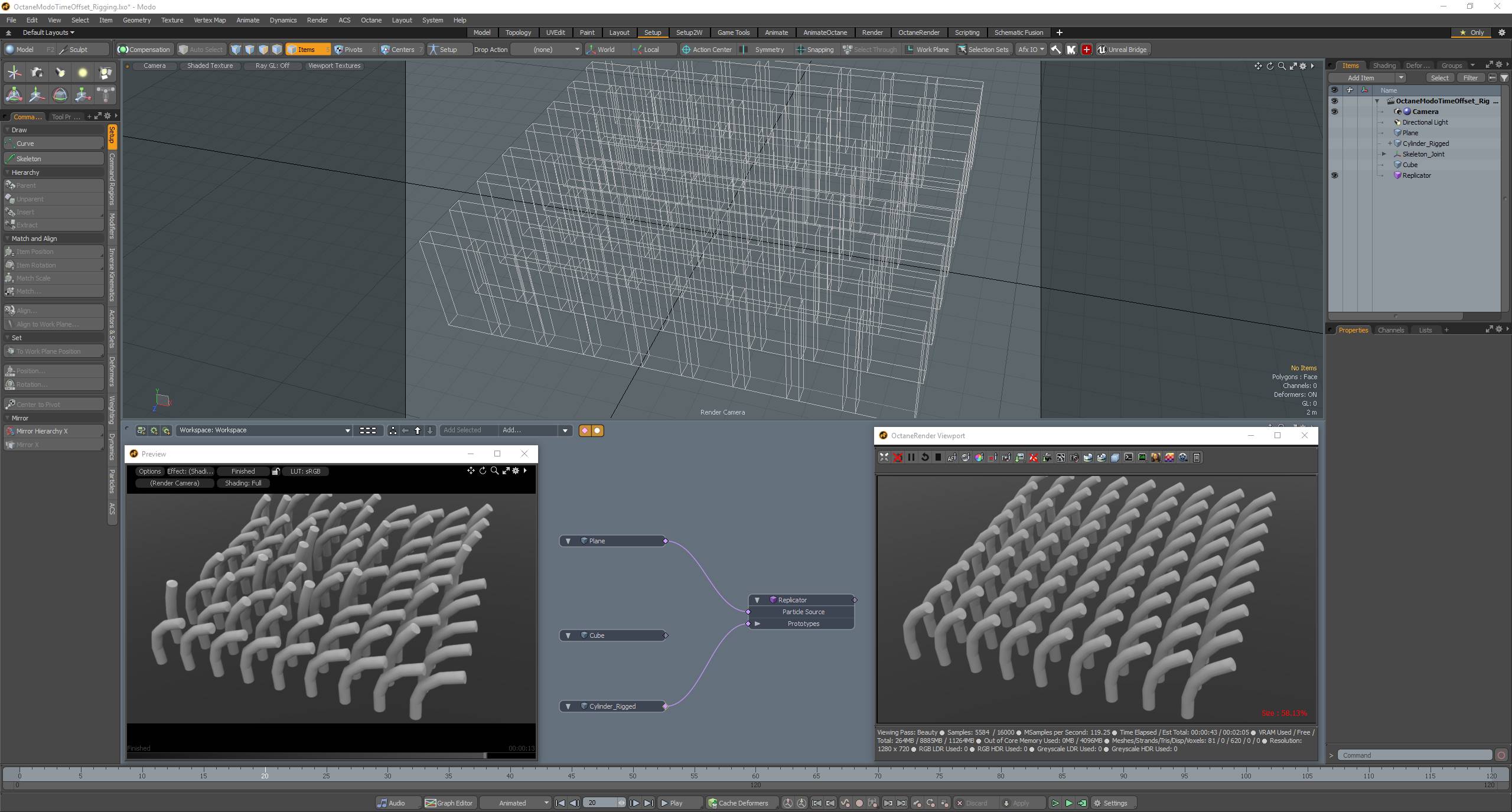

I'm using Modo's replicator with time variation to randomize the animation of an IK rigged mesh.
Octane plug-in doesn't render the "time randomization" from the rigged mesh
Cilinder Rigged Animation: Time variation not working

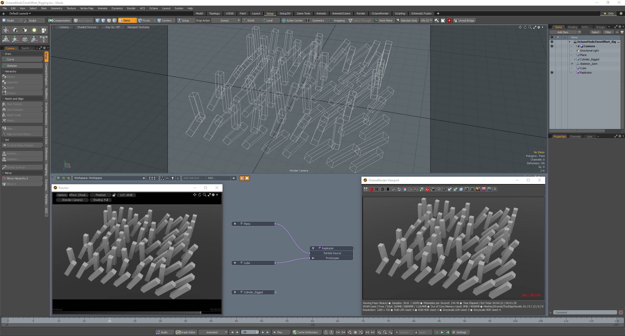

I did a setup with a simple cube, with a simple animated rotation (not rigged), and octane renders ok.
Cube Simple Rotation. Time Variation: OK

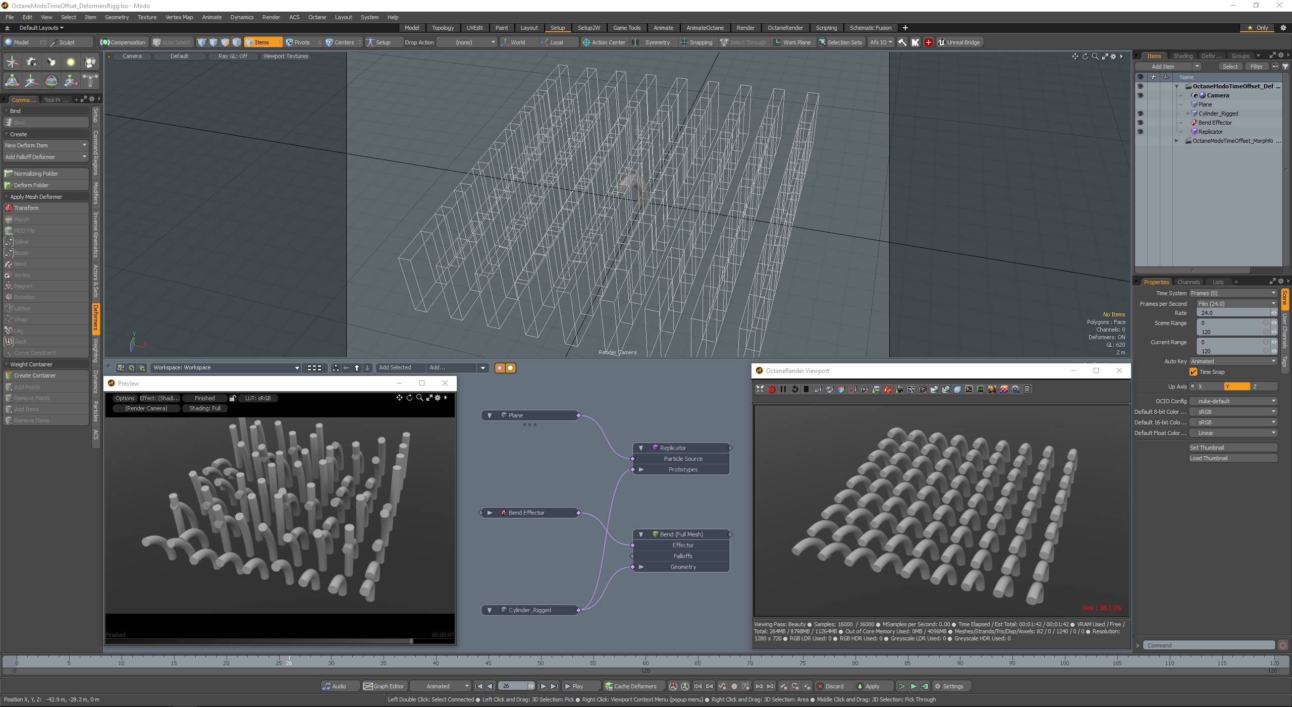

Octane is not rendering time variations defined in the replicator, if the "prototype" connected to the replicator is animated by any kind of Deformer
I'm posting two examples: in the the first one the prototype is animated by a bend effector ; in the second one the prototype is animated by a morph map.
Time Variation not working: Prototype is Animated  with a "Bend Deformer"

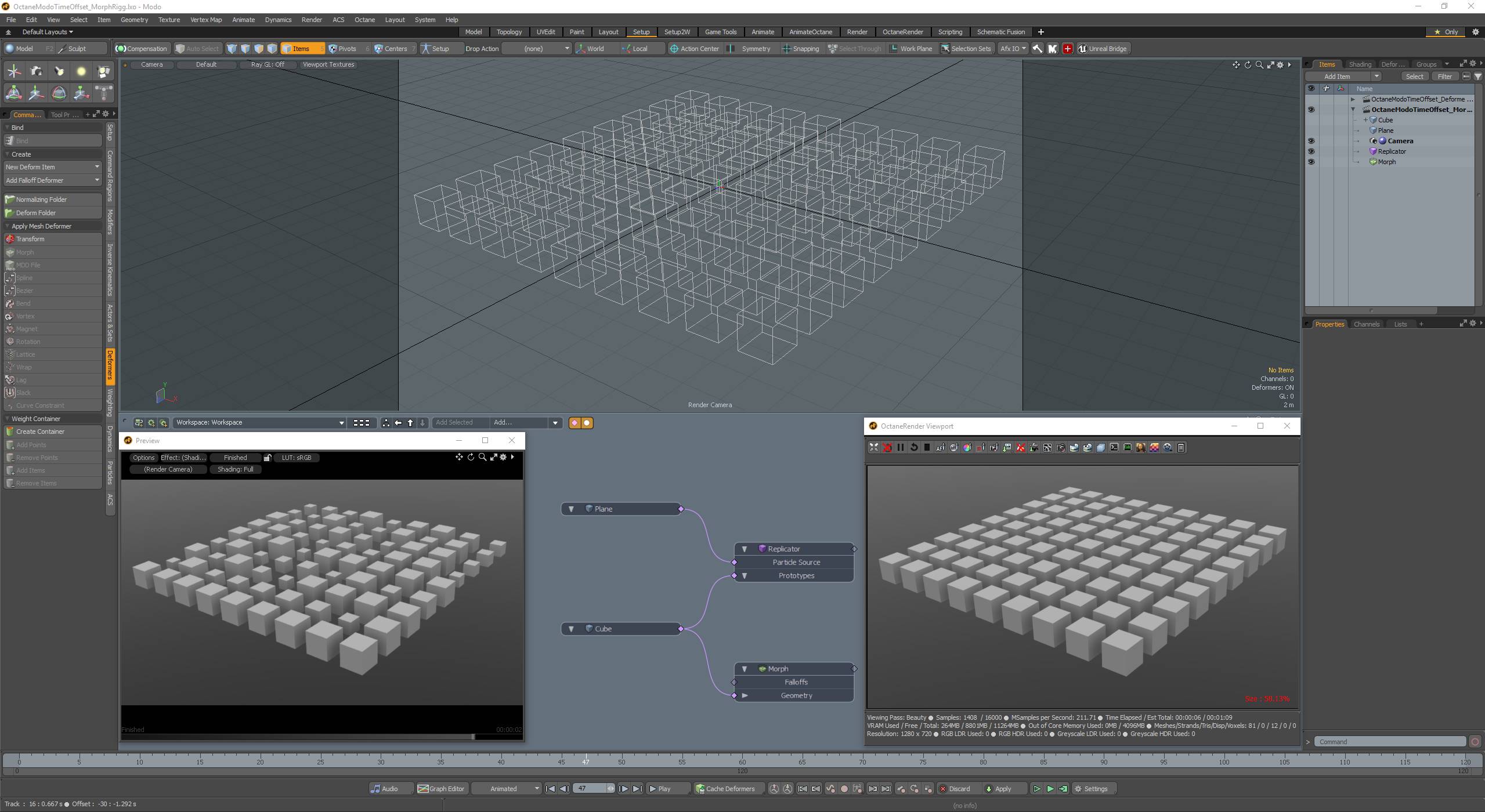

Time Variation not working: Prototype is Animated Using Morph Map
If I render with modo (preview and F9), it works. If I render with Octane it doesn't
I also tested exporting an deformer animated mesh to an MDD, and then connecting the MDD+Mesh to the replicator with time variation. Didn't work either in Octane

Hi - as per my response to your other question - the Modo Replicator is converted to an Octane Scatter node (so the transform for each replicator point becomes an Octane Scatter instance transform). Therefore all instances will render as the same (ie. identical) mesh. So to render your scenerio correctly - you would need to use separate Mesh objects rather than a Replicator.
I hope that helps.
