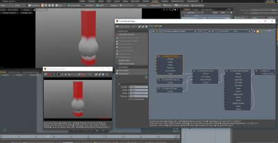

Hi .
As the subject says, I need a gradient driven by an object... any way to do this in octane or pass the modo gradient rig to the plugin ?
Dealing with this and no info about.
Thanks in advance.
Gradient driven by locator

Hi Paul.
Thanks a lot.

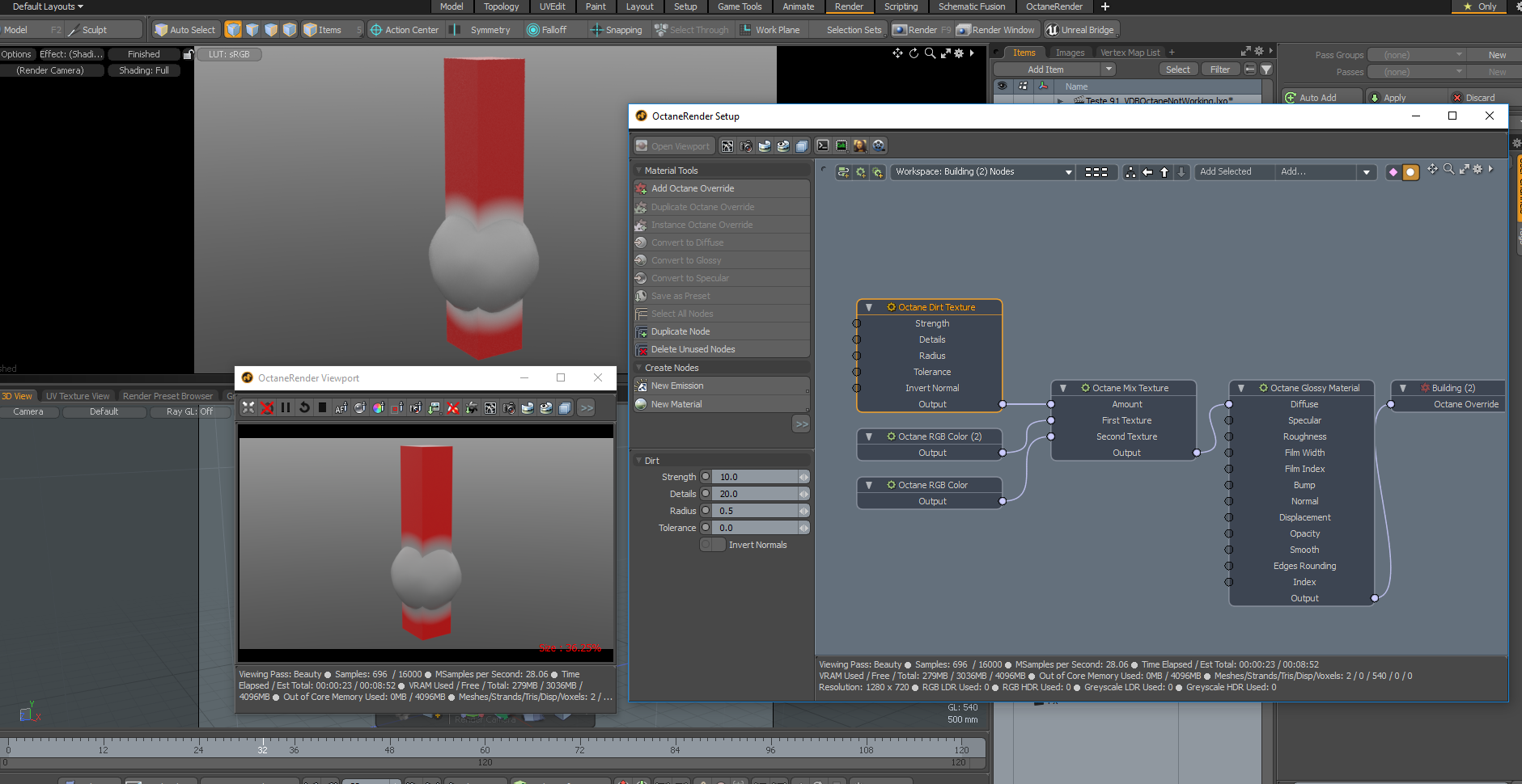

Attached a very basic file with the effect I need.
As I have no idea about how to deal with that in Octane, it's only rigged with modo native nodes.
Thanks a lot.
Thanks for providing that scene. I could not achieve the result you are looking for with a gradient, but was able to get close using an Octane Noise node.
Paul

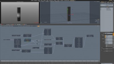

Hey there,
maybe you can use this "hacky" approach: I basicly connected the locators position to a gradient:
I thougth i can just do this for the x y and z axis and multiply the results. It kind of works but it's not that pretty. Btw. @Paul is it possible to feed multiple Float values into a NodeGraph? I can create multiple Inputs but there are not present in Modo.
Greetings!
Greetings!

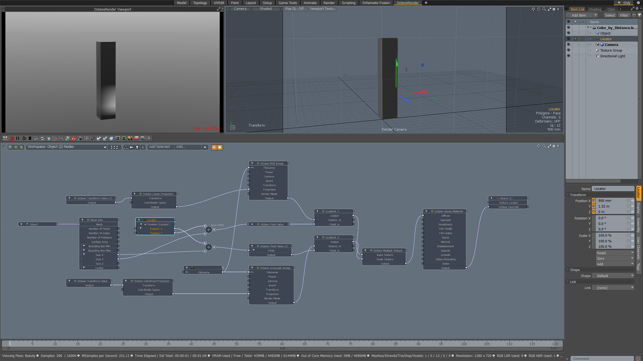

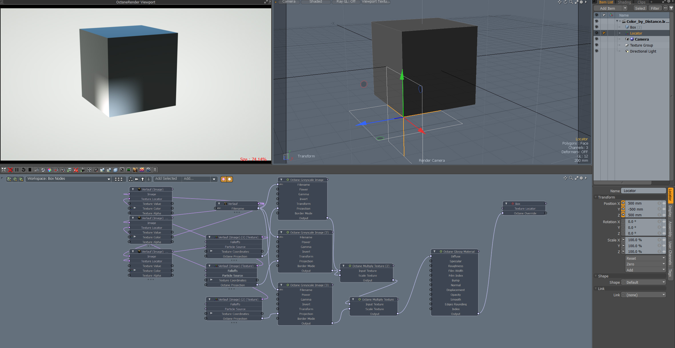

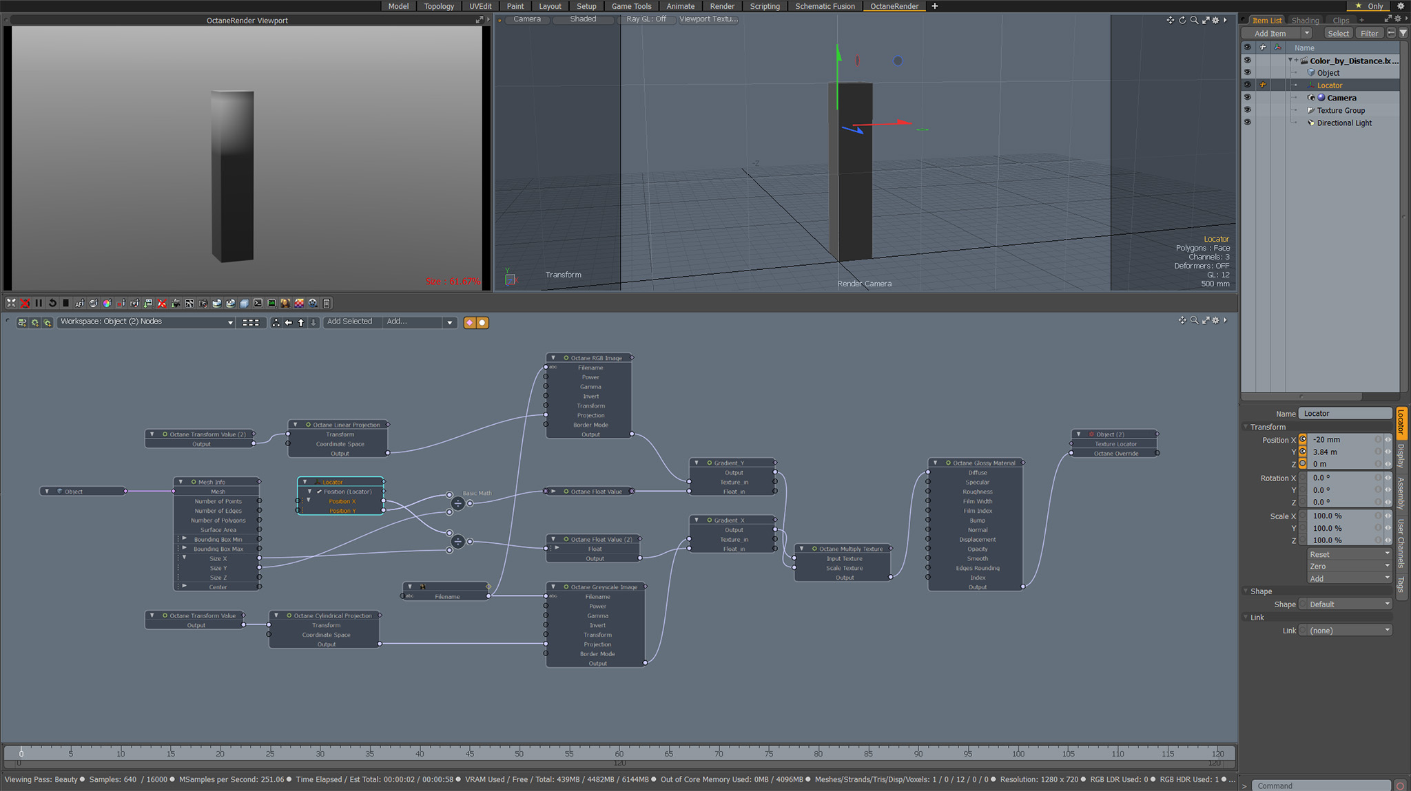

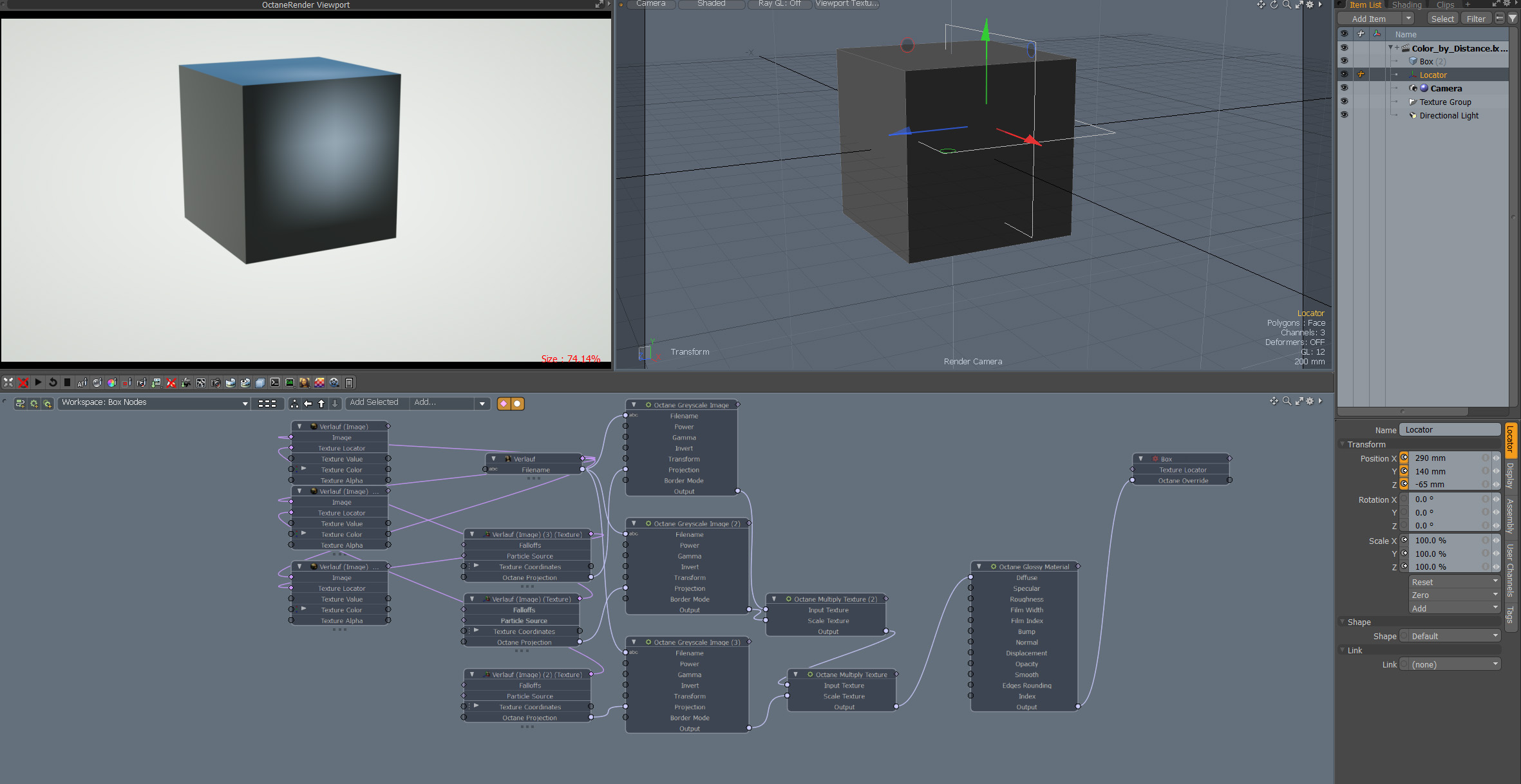

Ok, i thougth about it and build another rig. This is much simpler and looks better:
- Attachments
- Color_by_Distance.zip
- (83.97 KiB) Downloaded 208 times
