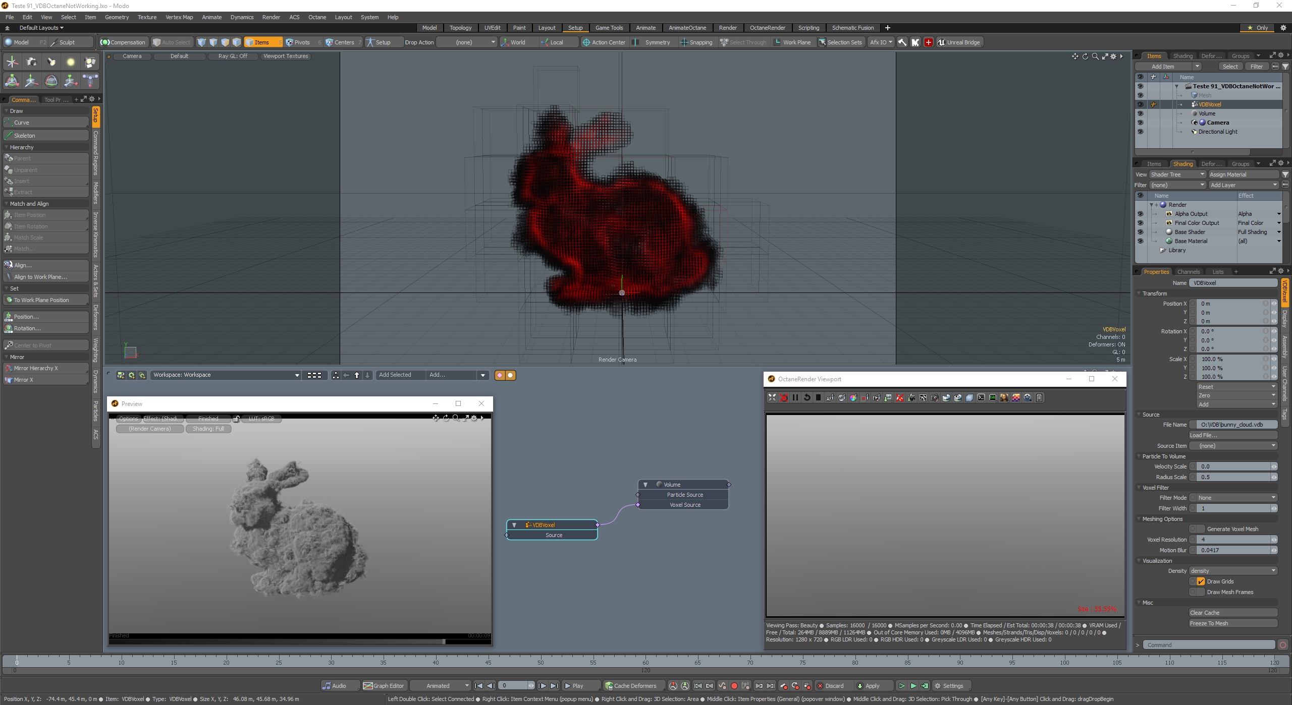

I don't know if the issue I'm having with VDBs in Octane For Modo is related or not to that bug. I'm Uploading the images and .LXO

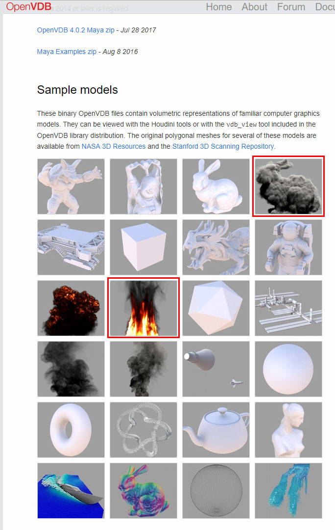

I downloaded these .VDBs from http://www.openvdb.org/download/
And did a setup in MODO 11.1
Octane renders the "fire.VDB", but not the "bunny_cloud.vdb".

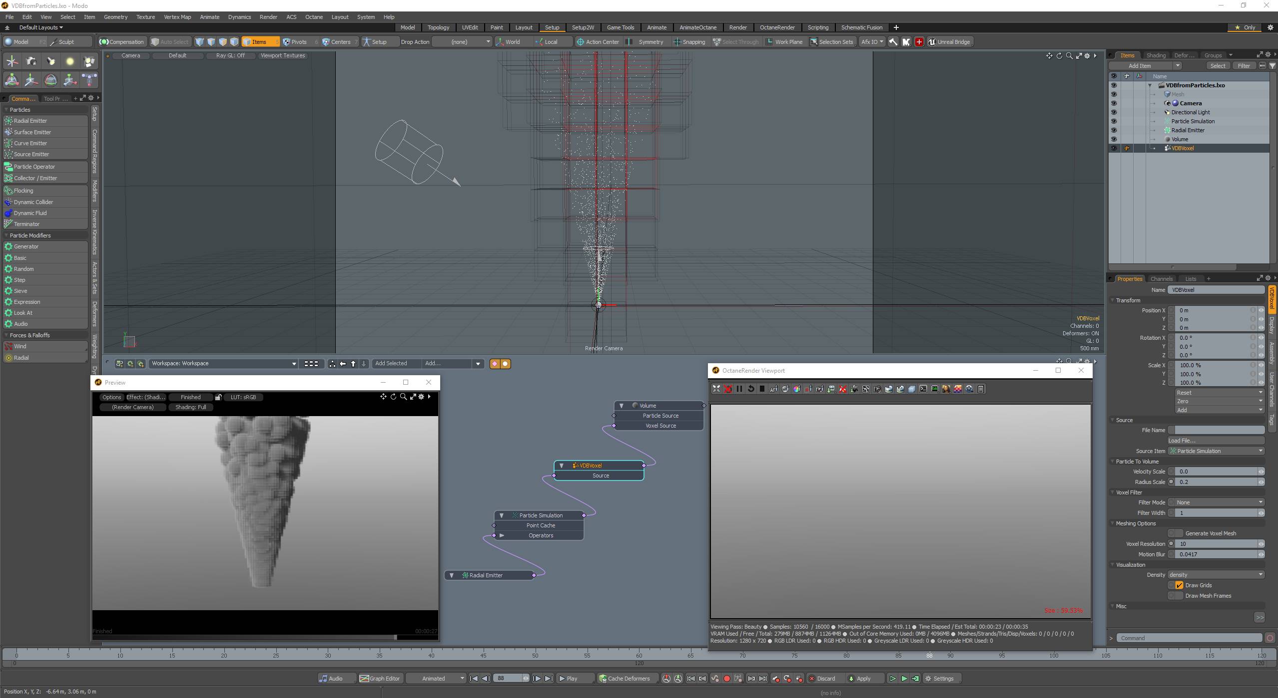

I also dd a test setup with a sphere mesh as a vdb source. Octane doesn't render it.
Are the bugs related? If not is there a fix for this problem?

Downloaded and installed the test build 3.07.0.123
However now none of the examples I sent earlier are rendering, even the one that worked previously. :(
"bunny " : Still not rendering
"fire" (this one worked previously): not rendering now
"from mesh": Now i can edit the nodegraph connection on the octane override in the "mesh connected to vdb source". Previously it wasn't working. Still not rendering

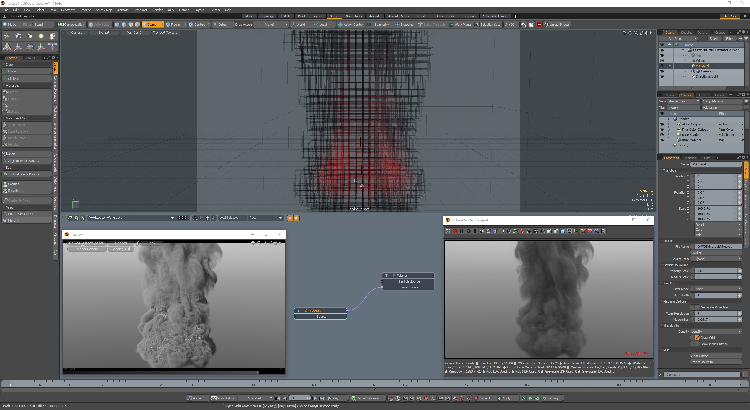

jtmsf
Posts: 58
Joined: Thu May 28, 2015 9:47 pm
Hi

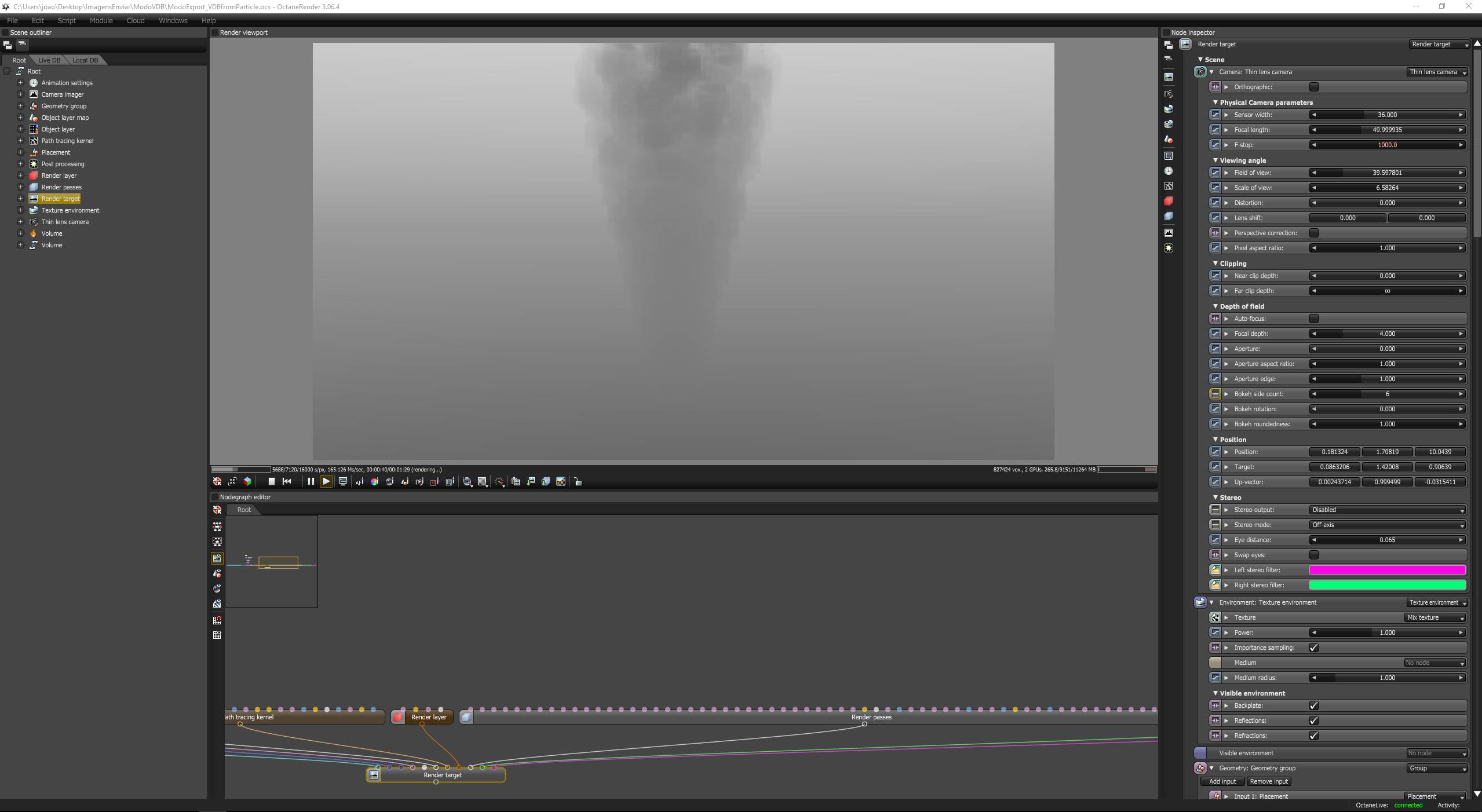

Here's a screenshot of the fire.vdb after installing test build 3.07.0.123
Remade the scene with all the steps in Paul's video tutorial (link below), in case i was missing something.
https://www.youtube.com/watch?v=0pTMl5G5sJU
Fire VDB not working now
Octane doesn't render fire.vdb volume anymore
(the other ones, "vdb from mesh" and "bunny.vdb" still don't render)
Thanks for any help in solving this vdb problem
OctaneVDB_FireNotWorking.zip
Lxo with fire.vdb
(9.6 KiB) Downloaded 230 times

An update:

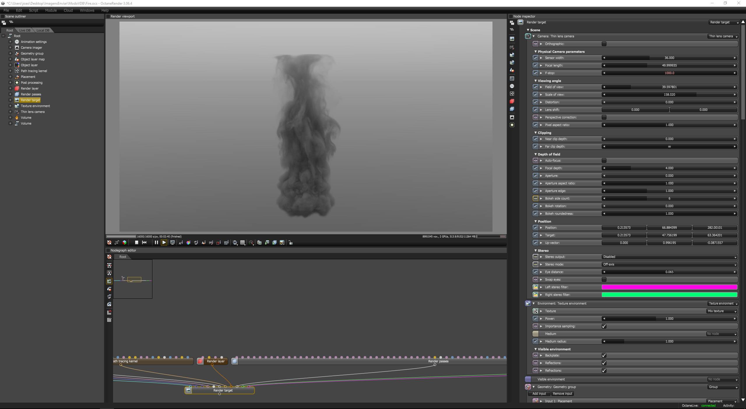

Inside Modo if I export "OctaneVDB_FireNotWorking.lxo" to .OCS format, and then open in octane standalone 3.06.4, it renders ok.
Screenshot from Octane Standalone
Fire.ocs
Exported from OctaneVDB_FireNotWorking.lxo
(34.08 KiB) Downloaded 254 times

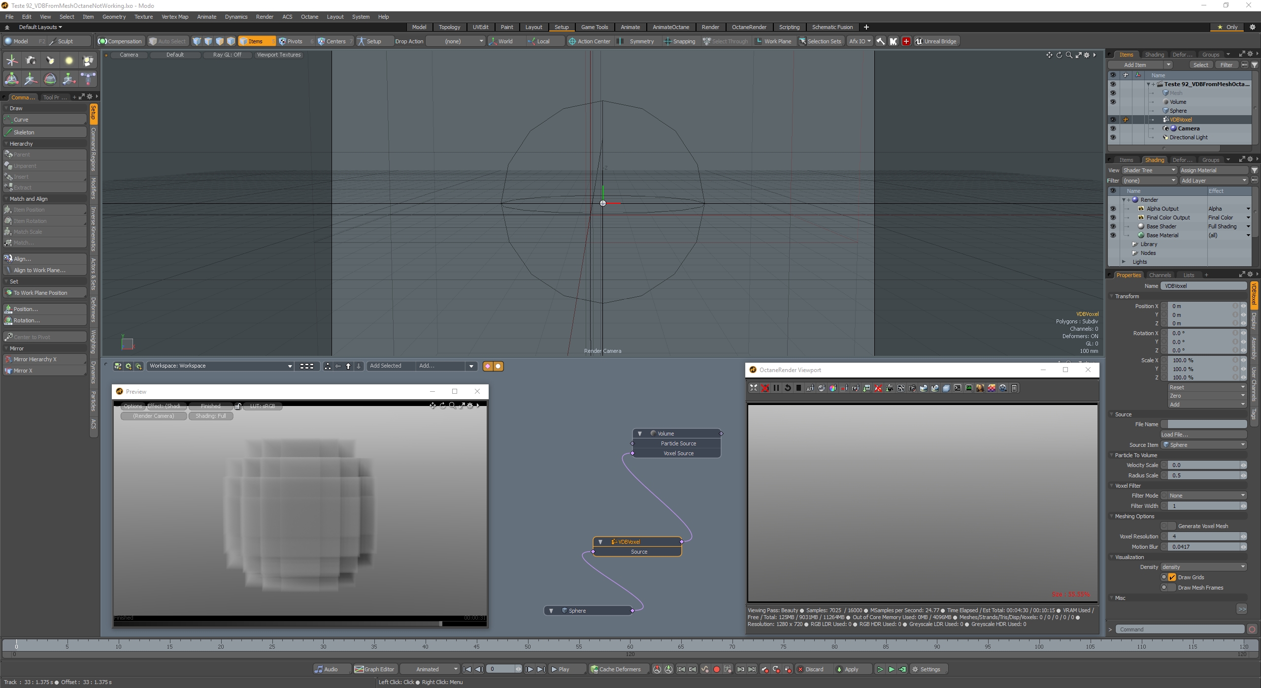

In Modo I made a simple setup using a particle simulation as a vdb voxel source, and then connected this vdb voxel to a volume.
Octane Plugin: does not render
Modo Setup, and octane plugin not rendering

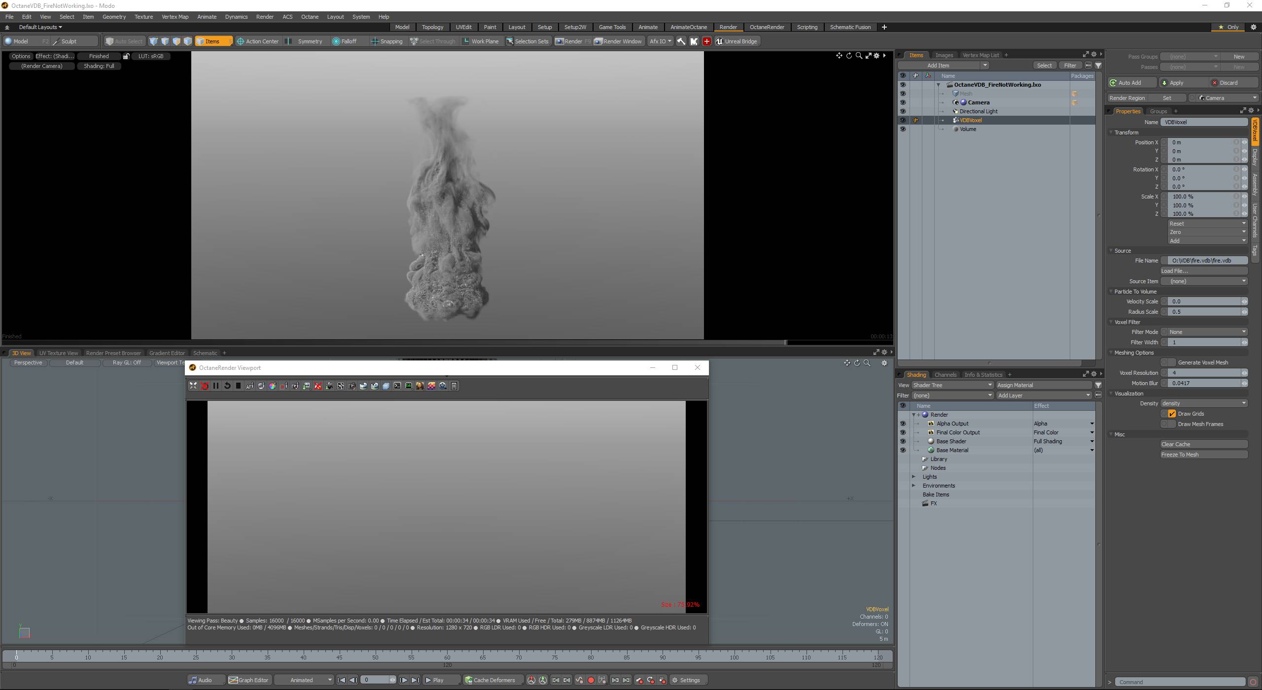

Then I exported the scene to a .OCS and opened it in Octane Standalone: rendered ok
StandaloneOctane_OCS from modo. Renders OK
I don't know if this helps finding the problem, but i'm posting anyway
