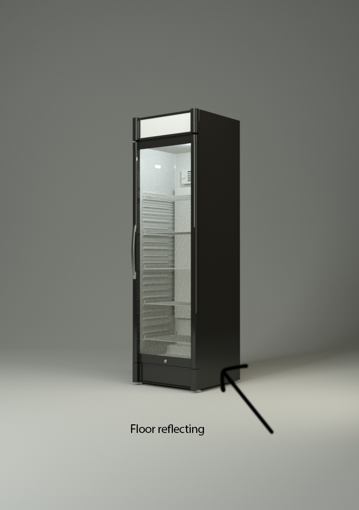

thanks for the reply, attached is a jpeg for the reflection issue.

use visible to specular=off for floor from 3.07test build.

Hi Aoktar,
my apologies, i'm really just getting started with Octane. Don't understand your reply, could you clarify a little more please. Sorry.
