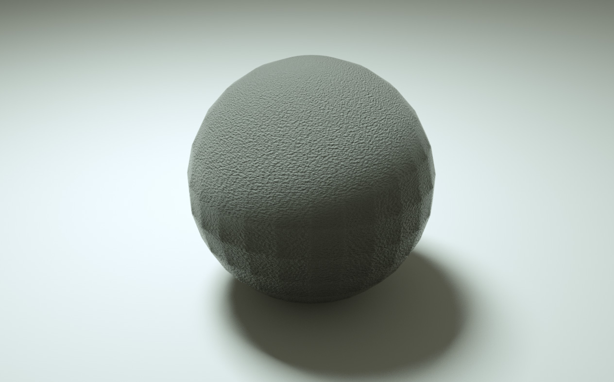

Hi folks,
I have a problem with phong smoothing and small bumps in C4D. Any Ideas to solve this?
Thanks and kind regards,
Arne
Can't attach the C4D file ... :-( But it's an easy setup. Gradient with a 0.05 uniform transformed noise lit by a area light.

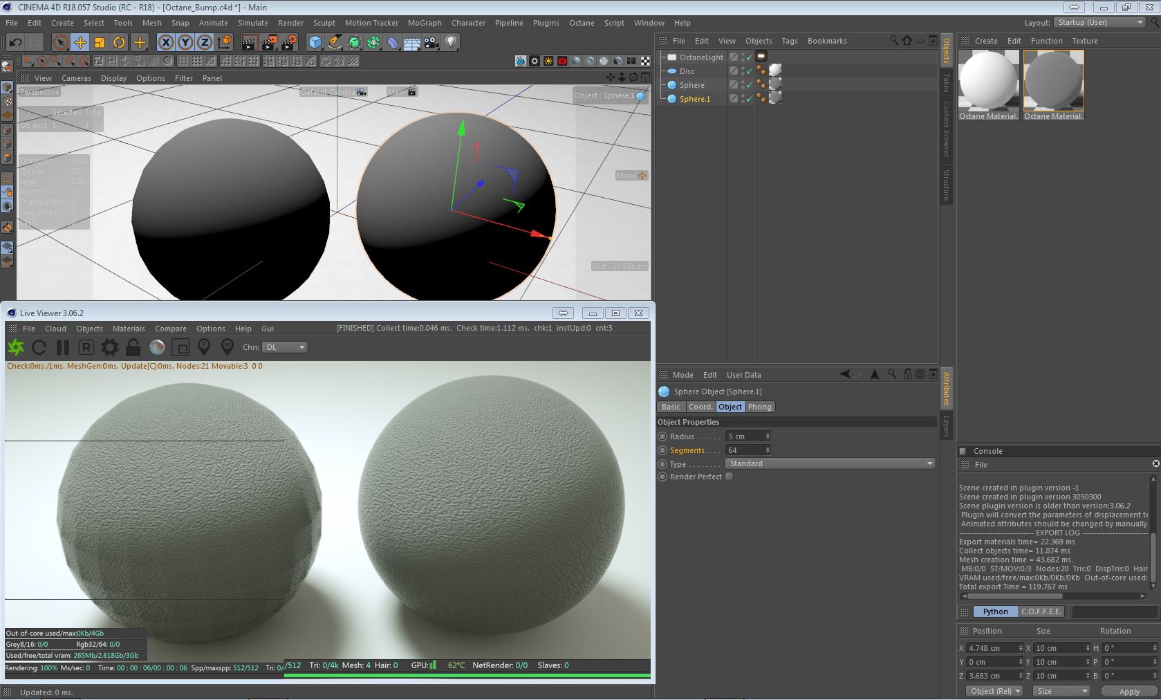

Hi Arne,
please check if in the Common tab of material you have unticked the Smoothing option.
Is this a standard c4d sphere, or imported from other 3d app?

This happened also on other objects. I first recognized it on a ffd formed loft. And than I tested it with different spheres (native cinema). It's more visible the smaller the bump is. And it doesn't matter if its a bitmapped bump or a procedural one. And even in an fresh scene with restarted workstation.

Posts: 10621
you need more subdivisions with Octane, only 25 are not enough, especially with high bump values, note also the borders of the spheres:

Hi Beppe,
thanks for your answer. I'll work with more subdivisions. I also found this solution. I'm new to octane and even C4D so I'm afraid to mis a button or two ... :-)
