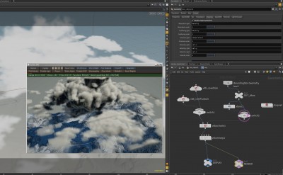

i managed to create an cloud object and it renders well, however cloud system rig does not show.
i tried to add octane params to it but no luck.
is there i way i can make octane see the cloud rig system?

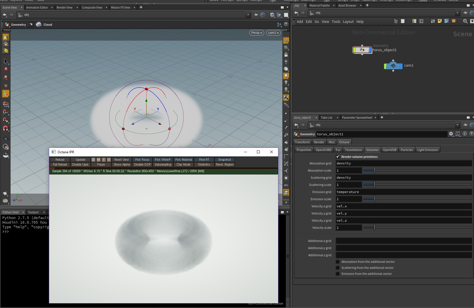

The cloud rig objects are conventional Houdini volume objects, so they can be rendered as Octane volumes if you enable this option adding the Octane OBJ spare parameters.

sorry, i was actually referring to the skyrig system.
i tried to convert it into volume but nothing happens.
screenshot below. hope its possible to render.
simple/single clouds work indeed finde.

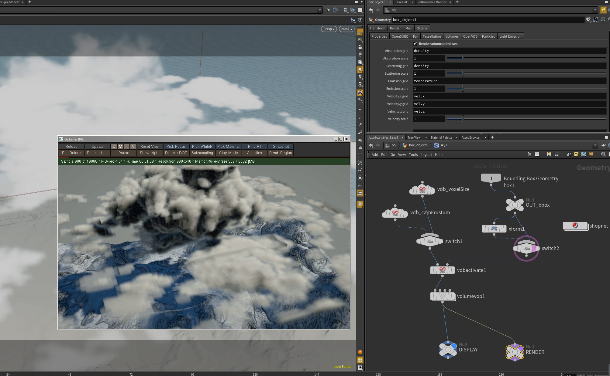

The problem is that somehow in your scene the render output SOP is not connected to the volume VOP, so nothing is rendered. You need to connect it like you can see in the attached scene. Also be sure to disable the OpenVDB file option in the OBJ spare parameters.
