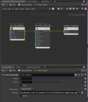

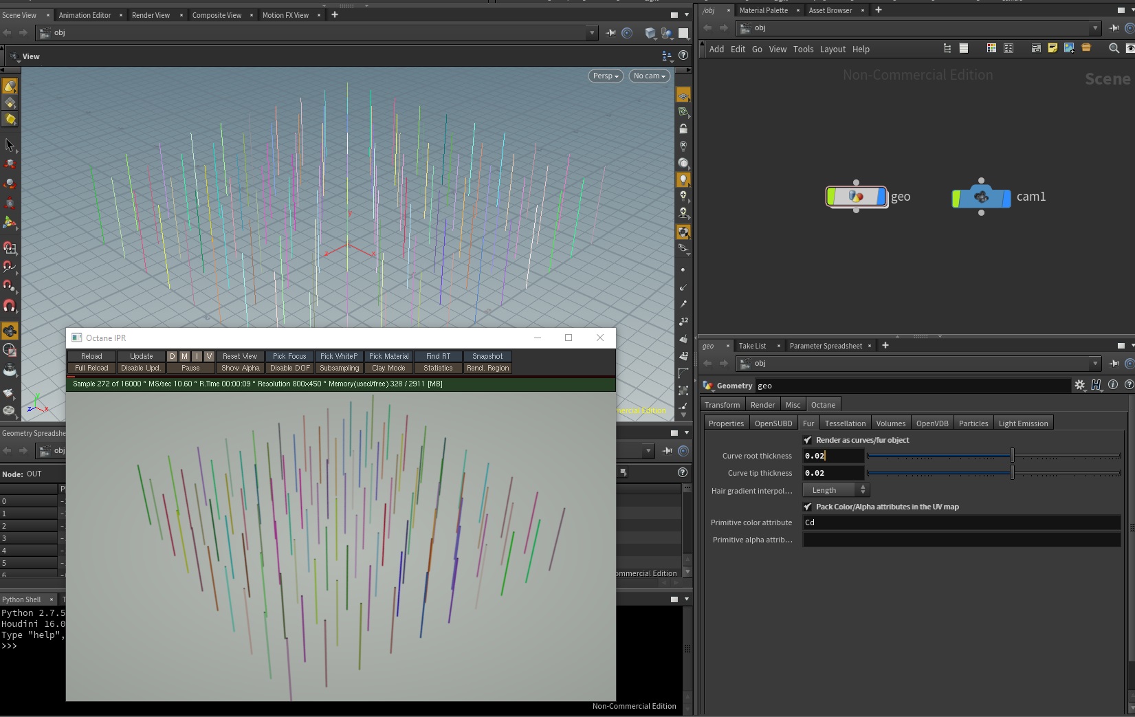

This is a test build for H16.0.600 and H16.0.633 with this new feature. You can enable it in the fur options, but be aware that the Cd attribute must be set at primitive level. Octane only supports one UV coordinate per curve.
Also, like happens with this same feature in the particle systems, you need to build a shader with a texture node pointing to the texture map available in the "tex" folder, inside the plugin directory. This texture map has the encoded colors needed to render the color attributes.

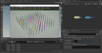

Hi guys,
i am trying to render, per point attribute color on a curves throw the uv tricks.
i do not intend to use the default tool base on prim color and the rgb4k_map.ppm.
in fact i would like to be able to render a gradient color on a single curves with only one primitive.
this method does work on curve mesh with a polywire, but it force me to convert my curves as polygon.
The problem is that i haven't find a proper workflow to have a different color for the root and the tip,
which is quite essential in a fur workflow.
I have attach a scene to describe the pb.
Cheers
E

well i think this answer my question
viewtopic.php?f=101&t=63452
so no octane can't read uv attribute at point level to bypass, the attribute access restriction.
it can however shade root and tips by using Tool W Coordinate.
this whole attribute blindness of octane to geo att is really a real pita for houdini users.
i'm also afraid like mention in the post that the osl texture support won't help in that case.
It's kinda the never ending story for me , because i've replace Maxwell by Octane,
having spend a lot of time trying to get this feature with maxwell devs and it has never become a reality.
EDIT :
after testing, we can sucessfully shade tip and root base from texture, so that's great, i have attach a small exemple.
at the end:
- we can use Cd on a curves at prim level
- we can shade a curve with a ramp with the tool W coordinate
- we can shade root and tip base on texture with a mix texture combine with a tool W coordinate
- we can bake Cd attribute on a geo to a texture map to access them throw texture
That cover nearly all the scenarios, so that's a far better experience than Maxwell plugin for houdini.
the only scenario which is not covered is to
- rendered Cd attributes on a curves at point level.
but we can bypass this by using a polywire and the uv to attribute tricks bu using a ramp
Not perfect but still good enough !
