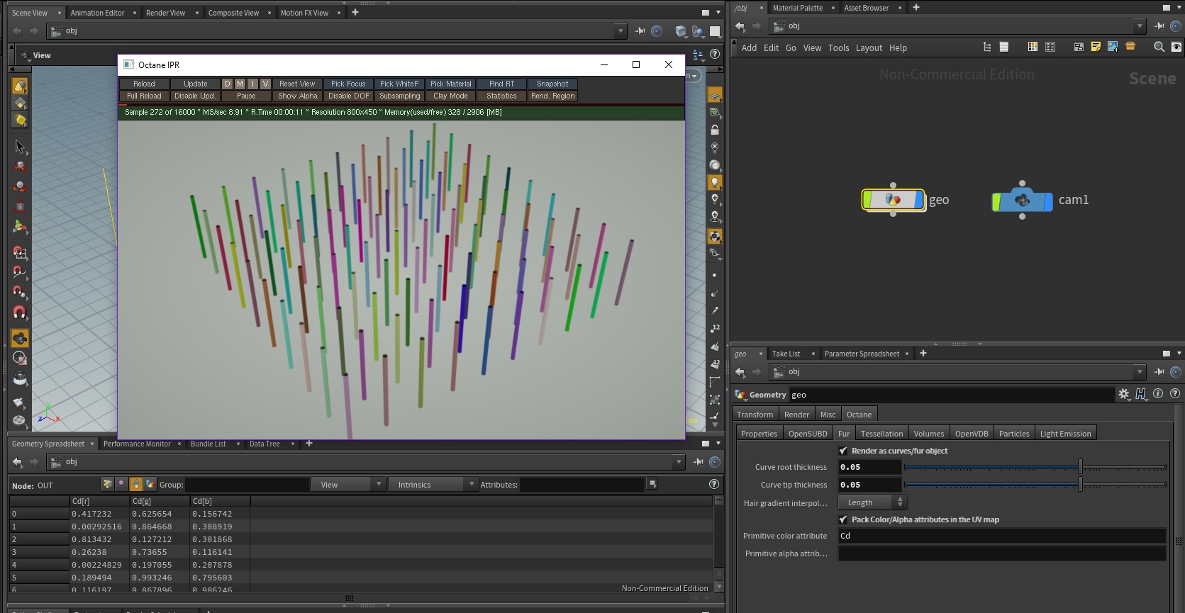

This is a test build for H16.0.600 and H16.0.633 with this new feature. You can enable it in the fur options, but be aware that the Cd attribute must be set at primitive level. Octane only supports one UV coordinate per curve.

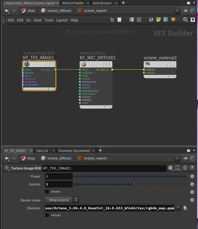

Also, like happens with this same feature in the particle systems, you need to build a shader with a texture node pointing to the texture map available in the "tex" folder, inside the plugin directory. This texture map has the encoded colors needed to render the color attributes.

Posts: 9
Joined: Thu Jan 26, 2017 8:55 am
Thank You so much for your quick response and the fix!
It works perfectly, You really saved me!
