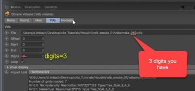

I have made a VDB animation from Houdini, output it with the smoke_$F4.vdb file name, which gave me a sequence of smoke_0001.vdb, smoke_0002.vdb, smoke_0003.vdb, etc.. The sequence goes all the way to 0079. When I try opening the animation via the Octane Volume object, I load the first frame of the vdb sequence under File, then Start 0 and End 79 but then it says VDB: Not Found!. What am I doing wrong here?

Increase the number in "digits" field.

Thanks for Answer,
There are 60 vdb files in the Folder.
from 001 to 060
