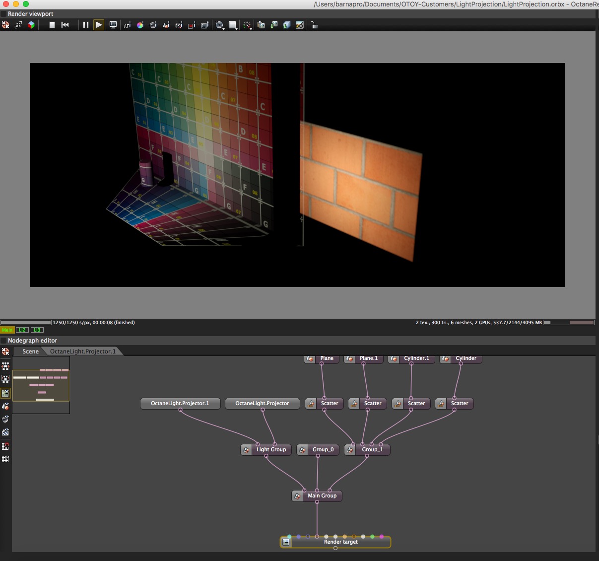

Hm, somehow i'm not able to get the same results in Standalone version , i mean even though i've assigned a texture on distribution channel, lighting texture is still way too blurred...

Posts: 10618
Hi AlexSudnikov,
here is the same scene in .orbx format:
LightProjection.orbx
(899.59 KiB) Downloaded 174 times
