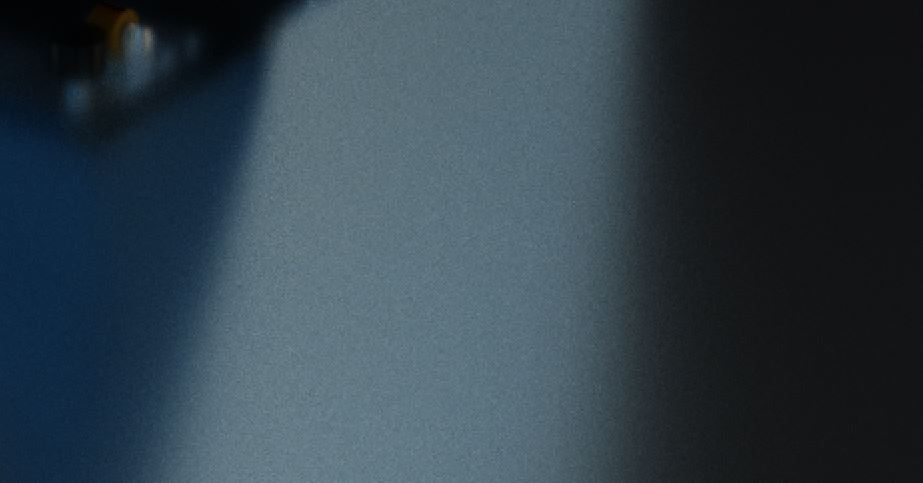

Hi Beppe,
Thanks for your reply. Unfortunatley I can't share the scene due to commercial restrictions of the project. Right now I can't provide a simple replica of the scene either because all my workstations are rendering.
But its actually quiet simple:
My object is placed on a shiny ground, to have more control over the reflection I disable the object via the camera tag (camera visibility turned off), enable multi pass/Reflections and save it seperatley.
Kernel is set to PT, 5000 samples (which clears the image completely in Beauty).
But I still get noise like in the attached image.
No matter if I increase the Kernel samples or the Info Layer samples in the multi pass settings.
6850k // 32 GB // 1080, 1080 Ti, 2080 Ti // Win 10 // C4D 19.068

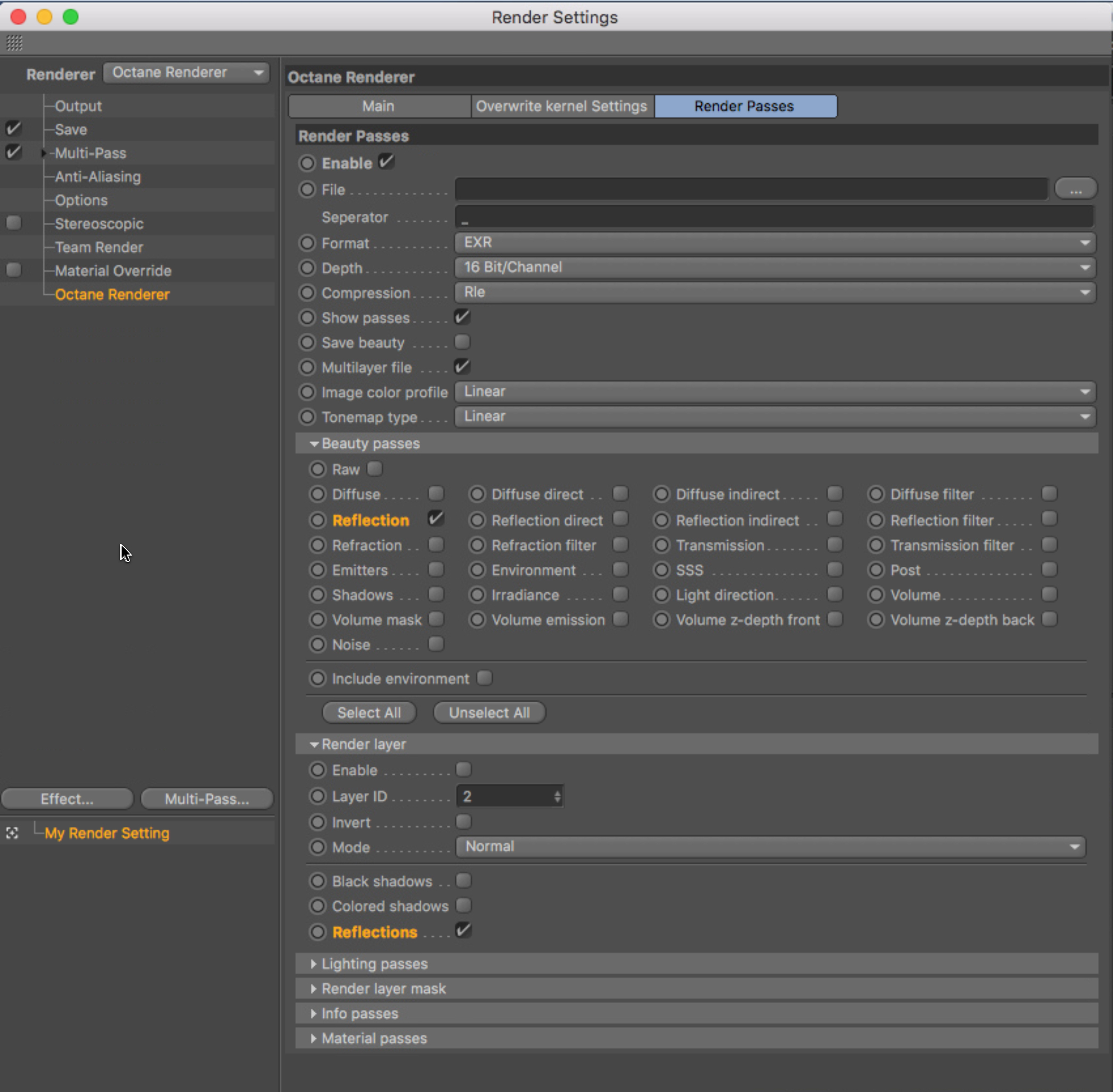

without the scene I can only guessing, but note that there are two different Reflections passes in the Render Passes tab:
The first one is related with the beauty passes, and needs to be mixed/layered with other layer passes to obtain the original beauty pass, so even if some residual noise is visible, it will be cancelled when layered in compositing:
http://www.aoktar.com/octane/BeautyPasses.html
The second one is related to the Render Layer technique to isolate bauty, shadows and reflections of an object in a scene:
http://www.aoktar.com/octane/RenderLayer.html
Which one are you actually using?

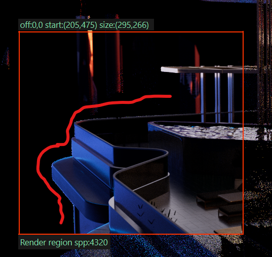

oh damn I am having this exact issue with aov render reflection pass.
Is there anyway to fix this?
adriendupagne
Posts: 62
Joined: Thu Mar 05, 2015 8:28 pm
there is a vdbvolume behind the balcony and when I turn the vdb off then the noise, aislising goes away.
Not sure how to solve it. I need the vdb volume tbh.
