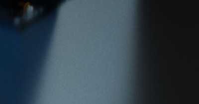

But its actually quiet simple:
My object is placed on a shiny ground, to have more control over the reflection I disable the object via the camera tag (camera visibility turned off), enable multi pass/Reflections and save it seperatley.
Kernel is set to PT, 5000 samples (which clears the image completely in Beauty).
But I still get noise like in the attached image.
No matter if I increase the Kernel samples or the Info Layer samples in the multi pass settings.

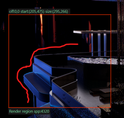

there is a vdbvolume behind the balcony and when I turn the vdb off then the noise, aislising goes away.
Not sure how to solve it. I need the vdb volume tbh.
