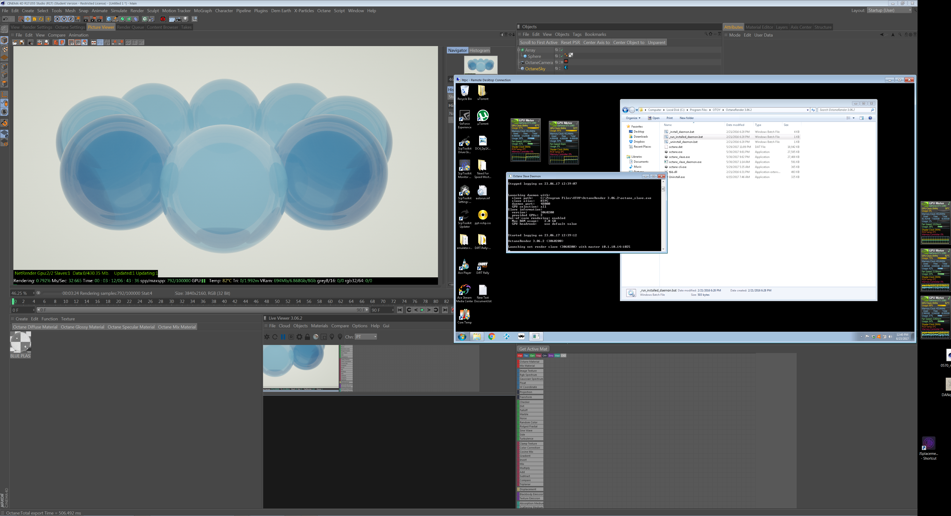

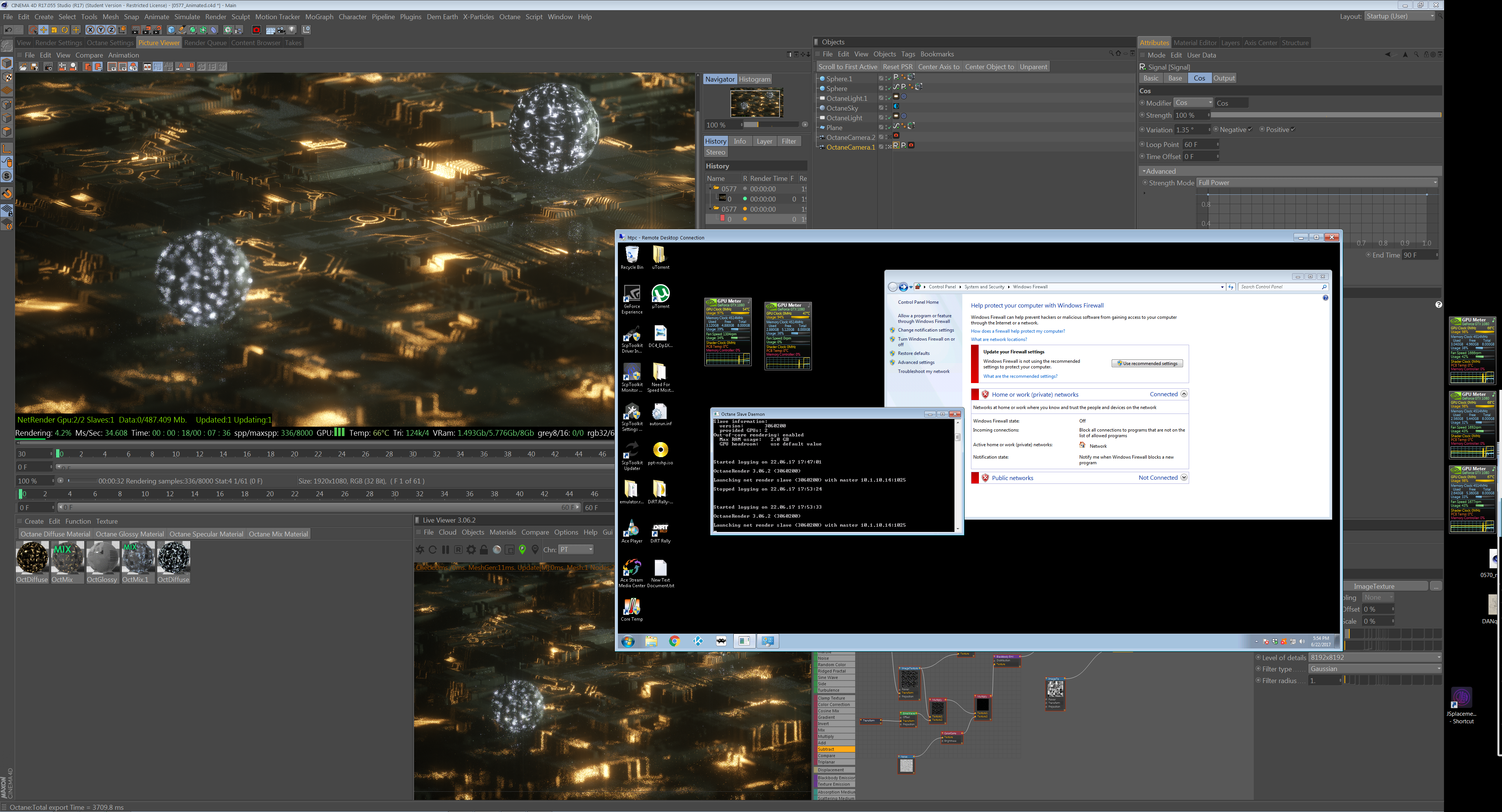

Anyone know what's going on with the slave? I'll attach a screenshot which shows it via remote desktop. AS you can see in the screenshot, all 5 GPUs are being utilized, but the slave command prompt isn't showing any data being processed.

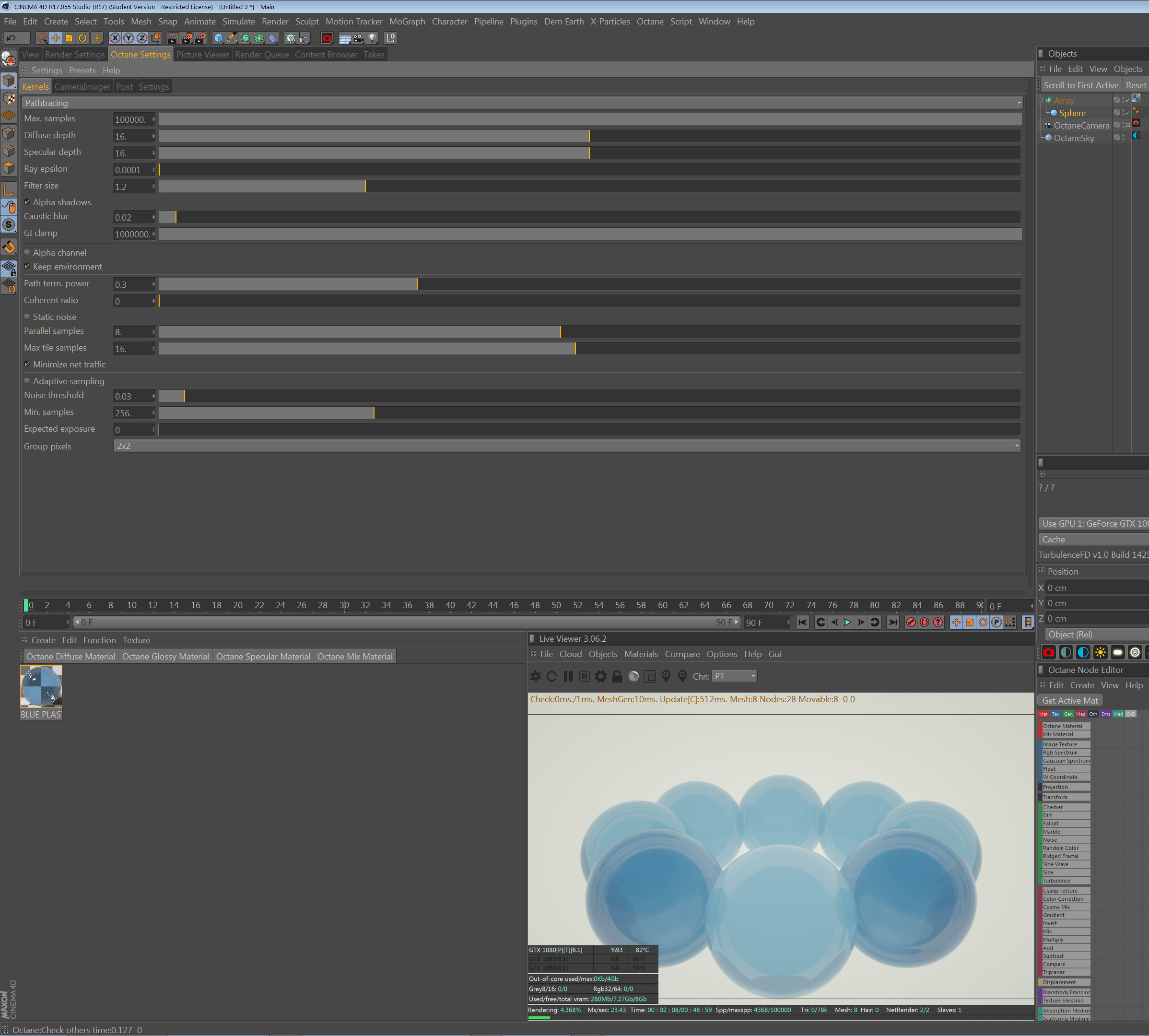

I am currently running another test render with an array of specular spheres via the pathtracing kernel and 100,000 max samples. The issue appears to be the same. The master will see and send data to the slave, but I'm not getting any data back from the slave.
I've attached an updated screenshot.

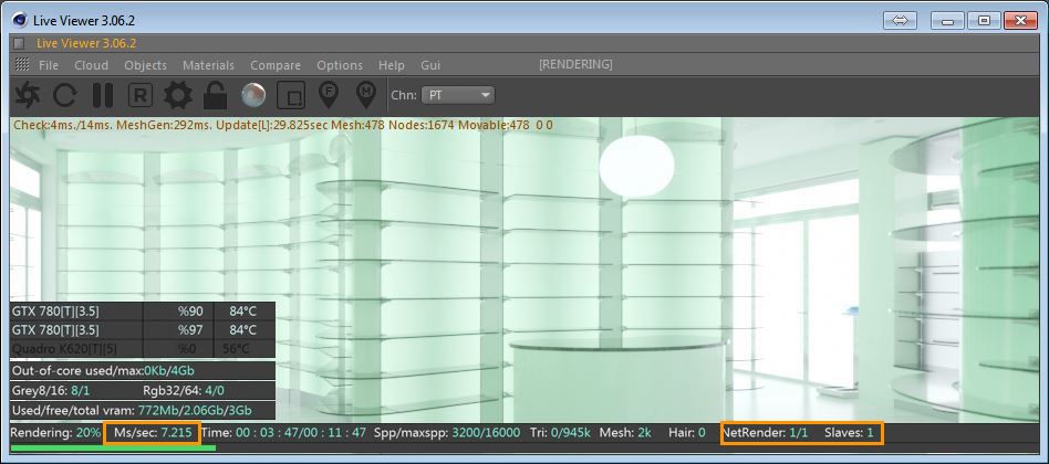

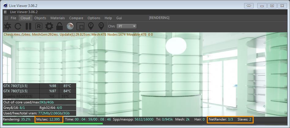

Here is what I obtain with the option disabled:
Internal GPUs only x2
Internal GPUs x2 + 1 Slave/1GPU
Internal GPUs x2 + 2 Slaves/3GPUs
ciao beppe

I have tried a test render with the minimize net traffic on and with it off, I get the same speed either time which is the same whether the slave is running or not. I've attached a screenshot of my typical kernel settings. I've also tried switching "Use All GPUs" on and off and it made no difference.
