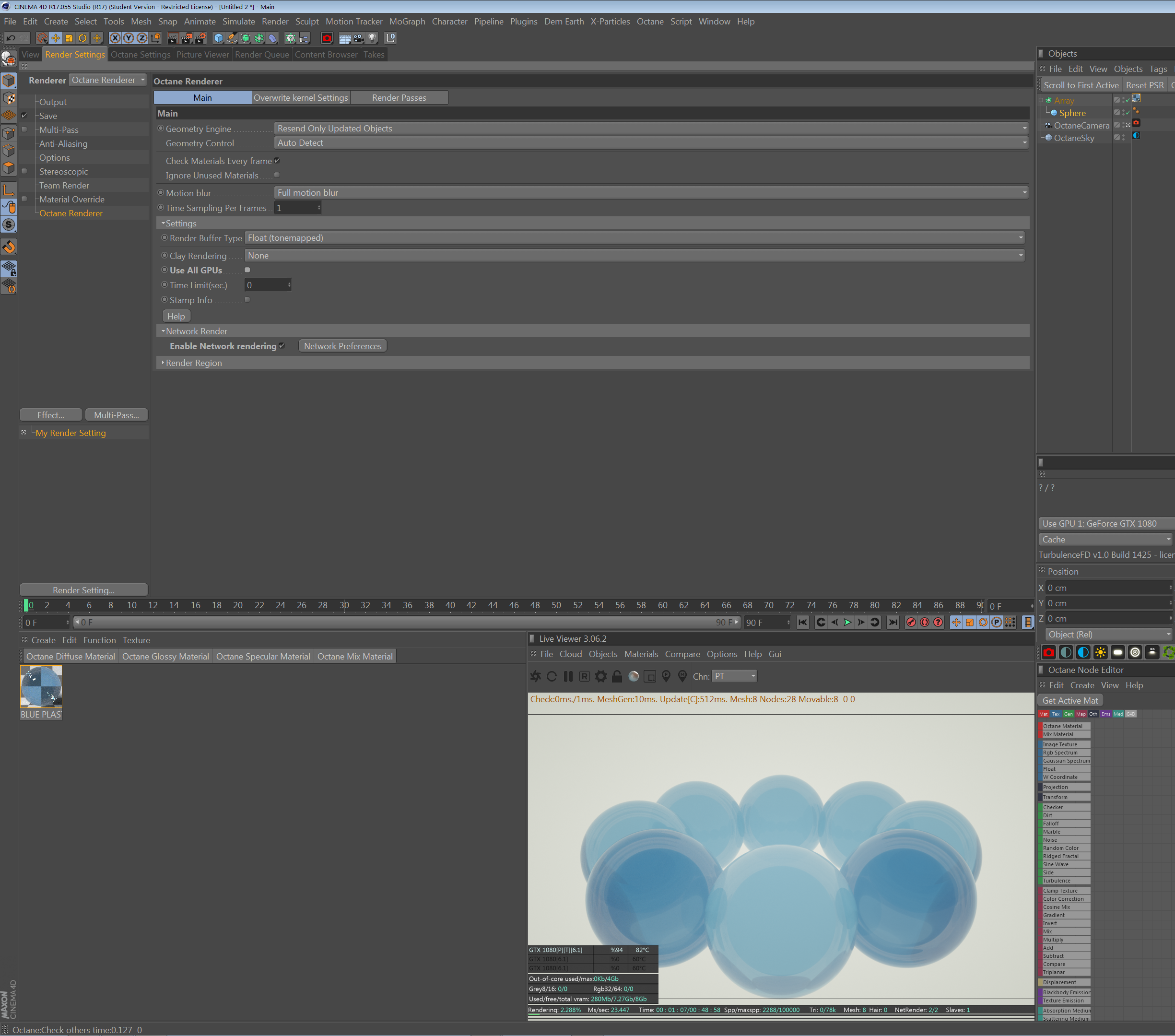

Hi bepeg4d,
I have tried a test render with the minimize net traffic on and with it off, I get the same speed either time which is the same whether the slave is running or not. I've attached a screenshot of my typical kernel settings. I've also tried switching "Use All GPUs" on and off and it made no difference.
