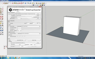

Hi, i resently change my pc, i'm installing all my programs again.
Well the exporter dosen't react.
I save, i click on octanes icon or i select octane from the file menu, nothing hapens ?
exporter dosen't react at all

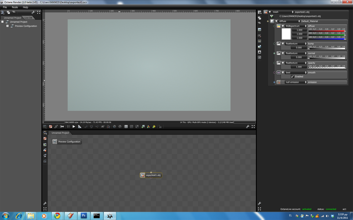

Weird!
If you edit the OCS to 'default the camera view' and then zoom out what do you see ?
If you erase the OCS from the folder so a new one is made what happens ?
I assume the 'scale' of the SKP objects is sensible - a few meters - as opposed to kilometers or micrometers etc.
Have you reset the SKP's axes - hover the cursor over an axis away from geometry and right-click context-menu should have 'reset-axes' if you have... This is grasping at straws in case the geometry is actually miles from the origin and breaking Octane, but it appears OK because the axes have be rest temporarily in that scene...
If this doesn't get fixed soon... then can you do the same export as you shown but with the following actions.

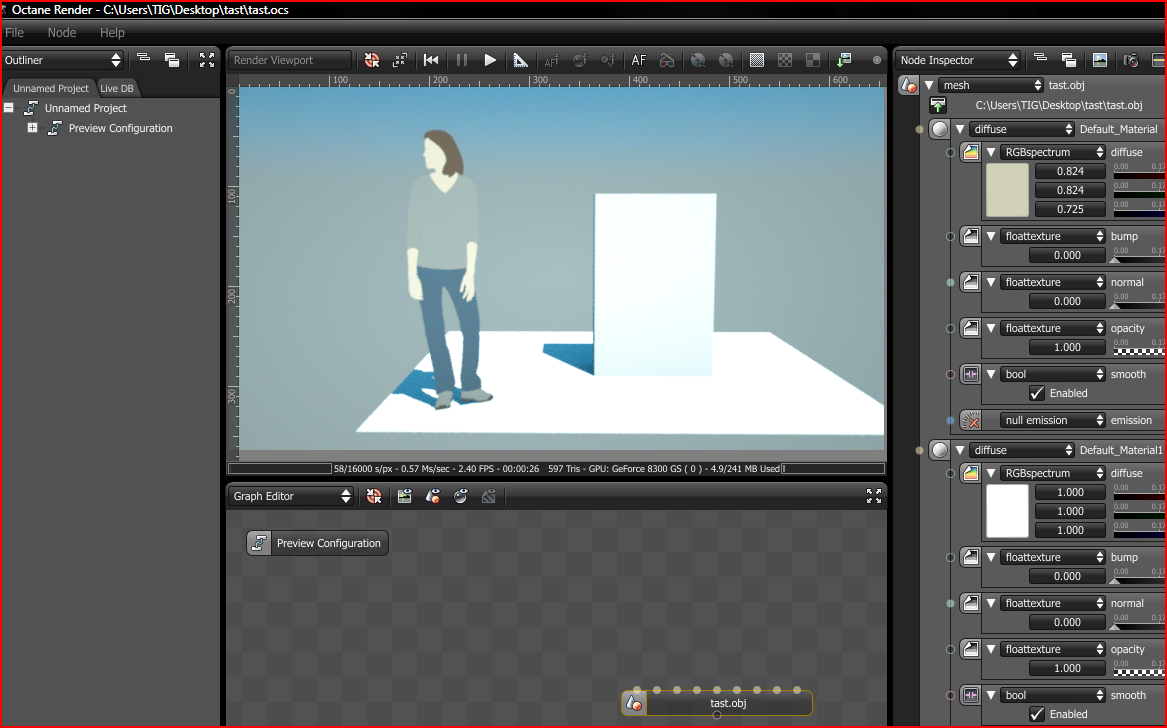

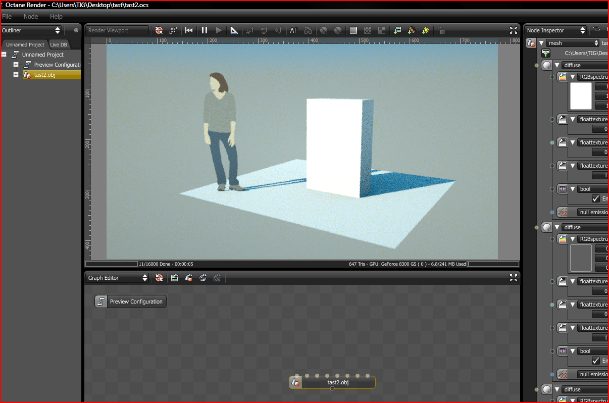

I got your rar by PM.
I agree that the OCS seemed empty.
The OBJ file had the right geometry in it.... so I deleted the OBJ node into OCS and manually imported the same OBJ.
It instantly worked. the updated tar2.OCS is in the attached zip file - retry it at your end. I'm not sure what the problem was - what is your Octane version? Mine's 1 beta 2.44
I also imported your OBJ file back into an empty SKP [tast.SKP in the zip] - which worked fine - and then I Exported it as tast.OBJ etc and opened as 'tast.OCS' which rendered fine too [also in the zip file]... I've attached the zip and the two images and a screen-shot of my Octane OBJ import settings in case you have something set oddly... Please let me know if you find the 'culprit'...

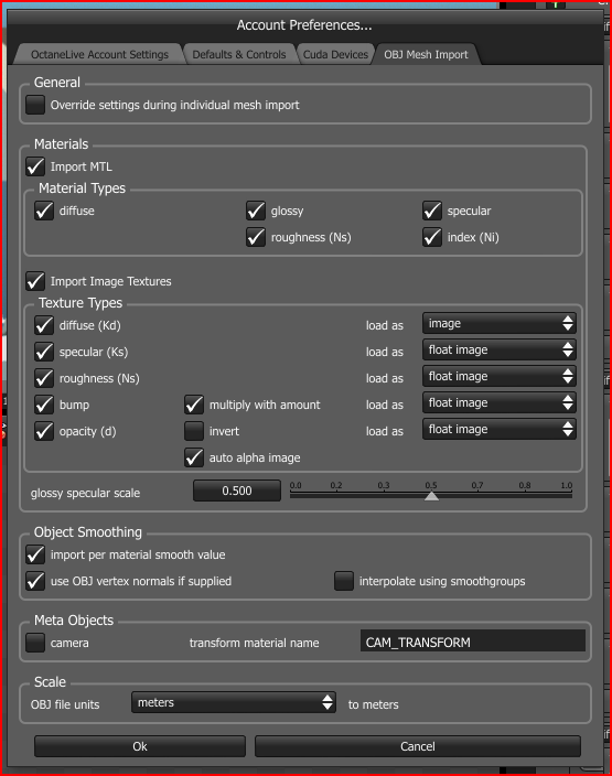

As I explained your OCS and SKP behaved perfectly - as I would expect.
Your OCS DID have something wrong with it [?] BUT if I reloaded the very same OBJ file it was then fine on my set up.
Therefore I must suspect there is something wrong with your 'Octane' preferences...
The exporter works fine for me [and many others], so I am forced to conclude that the problem is with your set up - especially when I can get a good result from the very same files you have supply ???
Have you check for the correct access rights to all of the folders and their files involved ?
Why would your supplied OCS not render anything on your PC BUT when it's on mine work fine with the same file ???
I am not privy to your PC's set up.
Are you an admin?
Do the folders involved in this have rights that let you read/write files etc etc ??????
