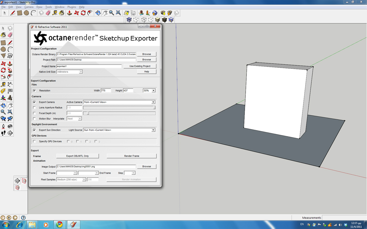

Ok this is what i get.
CPU: INTEL i7 3.40 GHz/RAM: 8 GB/GPU: 2XGTX690/OS: WIN 7 64 BIT/SKETCHUP 2014/OCTANE for SU
TIG
Posts: 536
Joined: Wed May 12, 2010 1:25 pm
Weird!
If you edit the OCS to 'default the camera view' and then zoom out what do you see ?
If you erase the OCS from the folder so a new one is made what happens ?
I assume the 'scale' of the SKP objects is sensible - a few meters - as opposed to kilometers or micrometers etc.
Have you reset the SKP's axes - hover the cursor over an axis away from geometry and right-click context-menu should have 'reset-axes' if you have... This is grasping at straws in case the geometry is actually miles from the origin and breaking Octane, but it appears OK because the axes have be rest temporarily in that scene...
If this doesn't get fixed soon... then can you do the same export as you shown but with the following actions.
Whilst the Exporter dialog is still open in the SKP the related 'octane.cmd' file is not yet auto-erased. It is to be found in the same folder as the OCS gets made... Can you make a zip file of it and attach it to a post/PM. Can you also zip up the related .obj/.mtl files and any _Texture folder [IF there are material textures in the SKP needed by the OCS] and supply those too...
