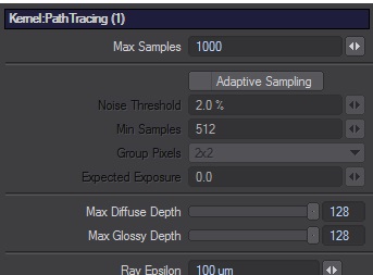

hi juanjo,
i think 36/36 ray depth for the PT Kernel is from case to case not enough! if you build a complex SSS shader with a second (or more) material layers with light transmission options i have the feeling thats not enough...
is it possible to enlarge the depth up to ...i dont no...96 or 128? :)

juanjgon
Posts: 8867
Location: Spain
You can type any number in the numeric field. In fact, in Standalone you can set at least 2048 rays, so I suppose that Octane supports it ;)
Great render, BTW!

oh my gosh i am so stupid! i never test it to type it in :) ok...stay tuned for the next renders....i think it would be much better with more depth :)

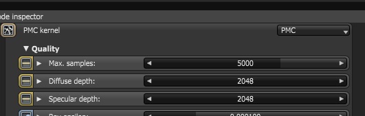

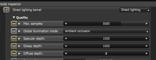

Hi Juan,
It seems we can put up to 2048 shading Depth samples in PathTracing Kernel right ? But is it the same rules or limitations for Direct Lighting and PMC Kernels ?
Thanks.
juanjgon
Posts: 8867
Location: Spain
Check the limits in the Standalone. The PMC kernel has the same limits, but the in the direct lighting kernel the limits are lower. I suppose that large values make no sense. I suppose that I should update the plugin to have these also these limits in the sliders.
