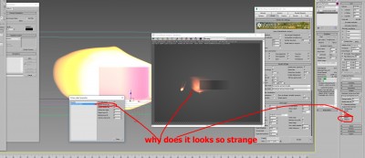

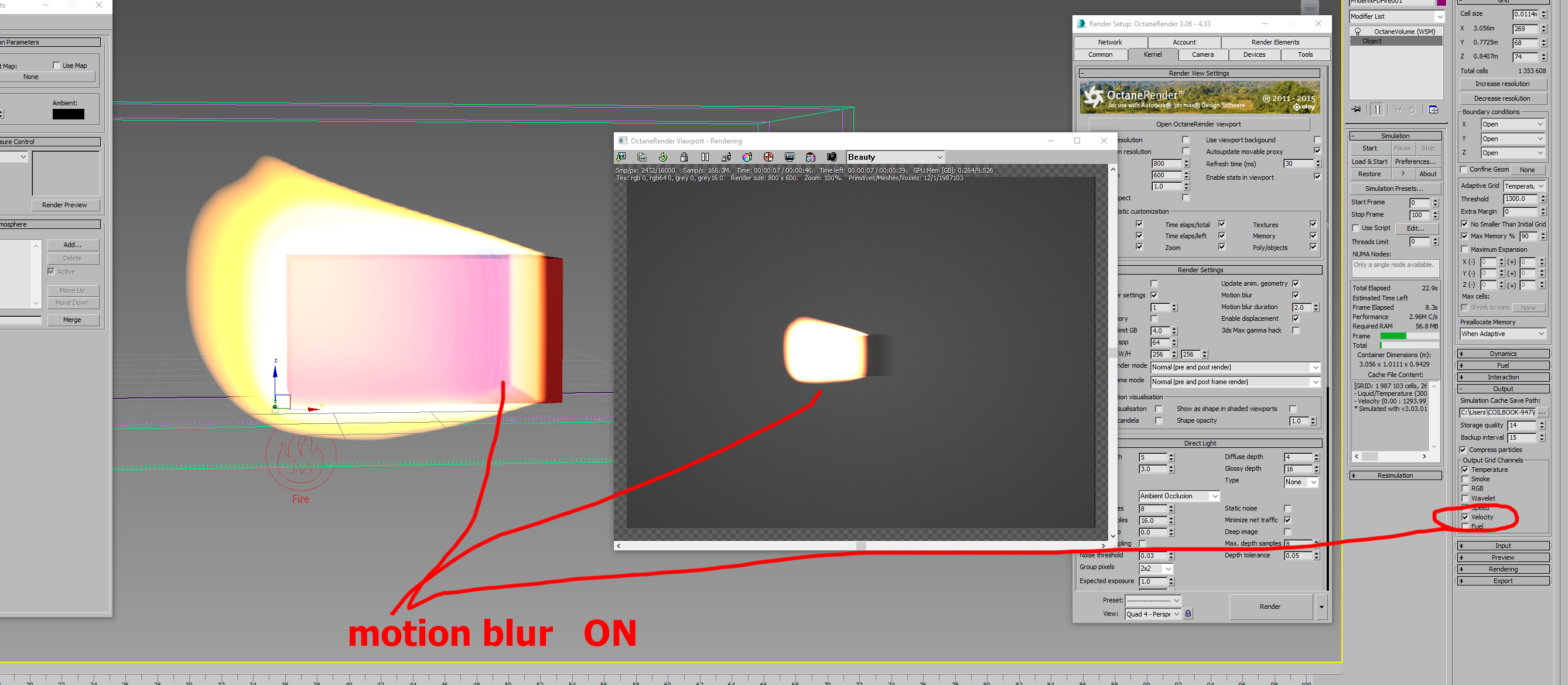

do we have to go to the properties for vdb sim box and enable motion blur and vertex blur. Motion blur looks strange in octane with fires
output velocity is checked in phoenix itself and fire source
do we need to enable MOVABLE proxy for VDBs?

i will. Do we need to set VDBs sims to movable proxies and check motion blur on? Or velocity channel through phoenix is enough

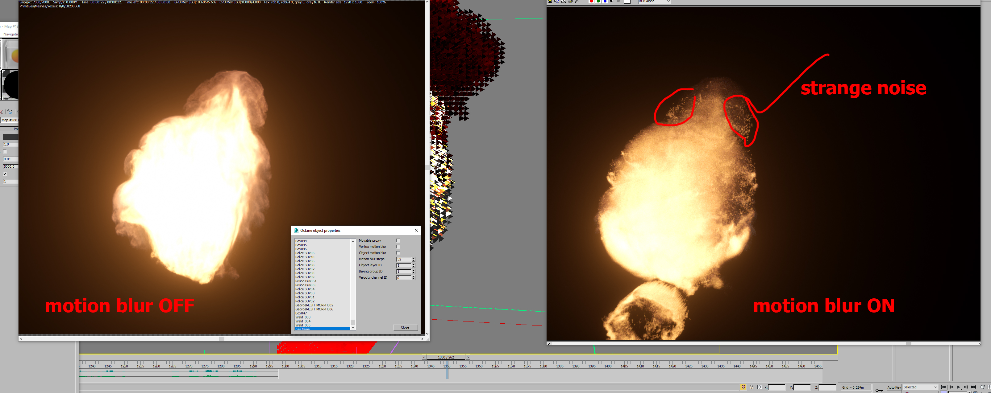

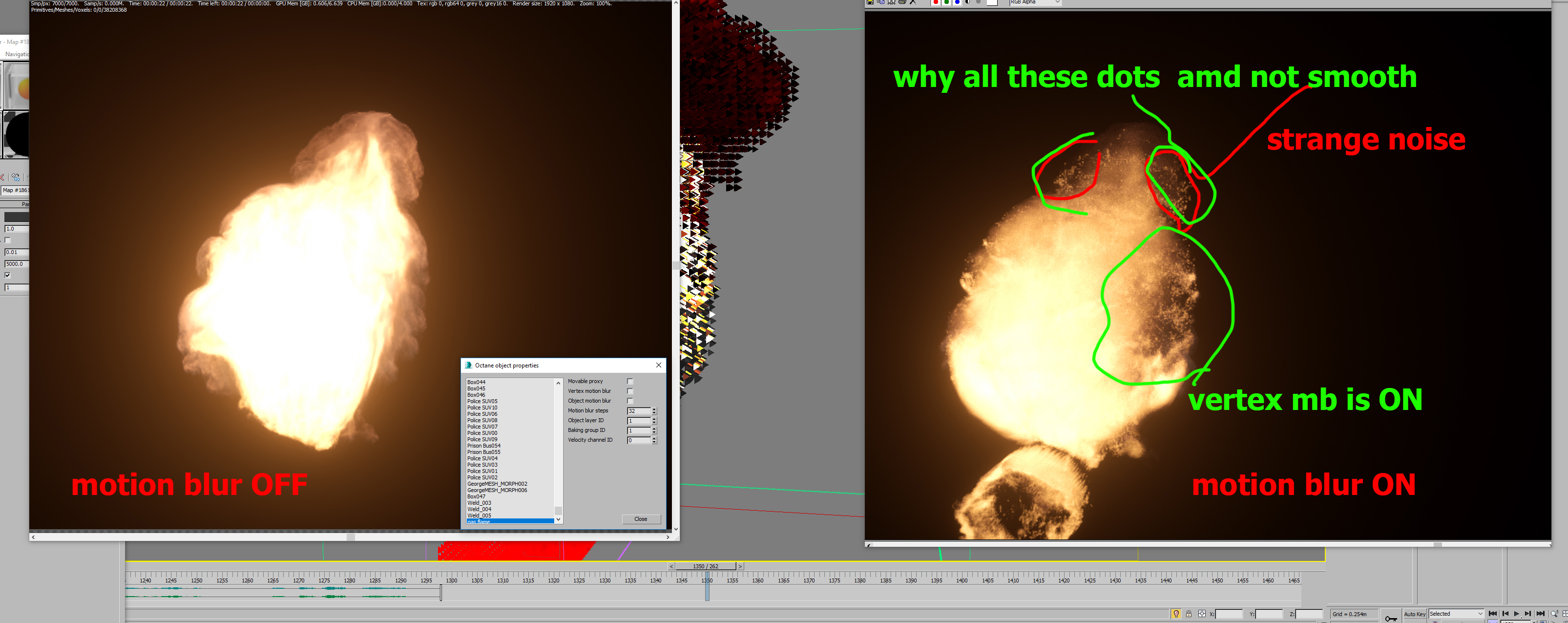

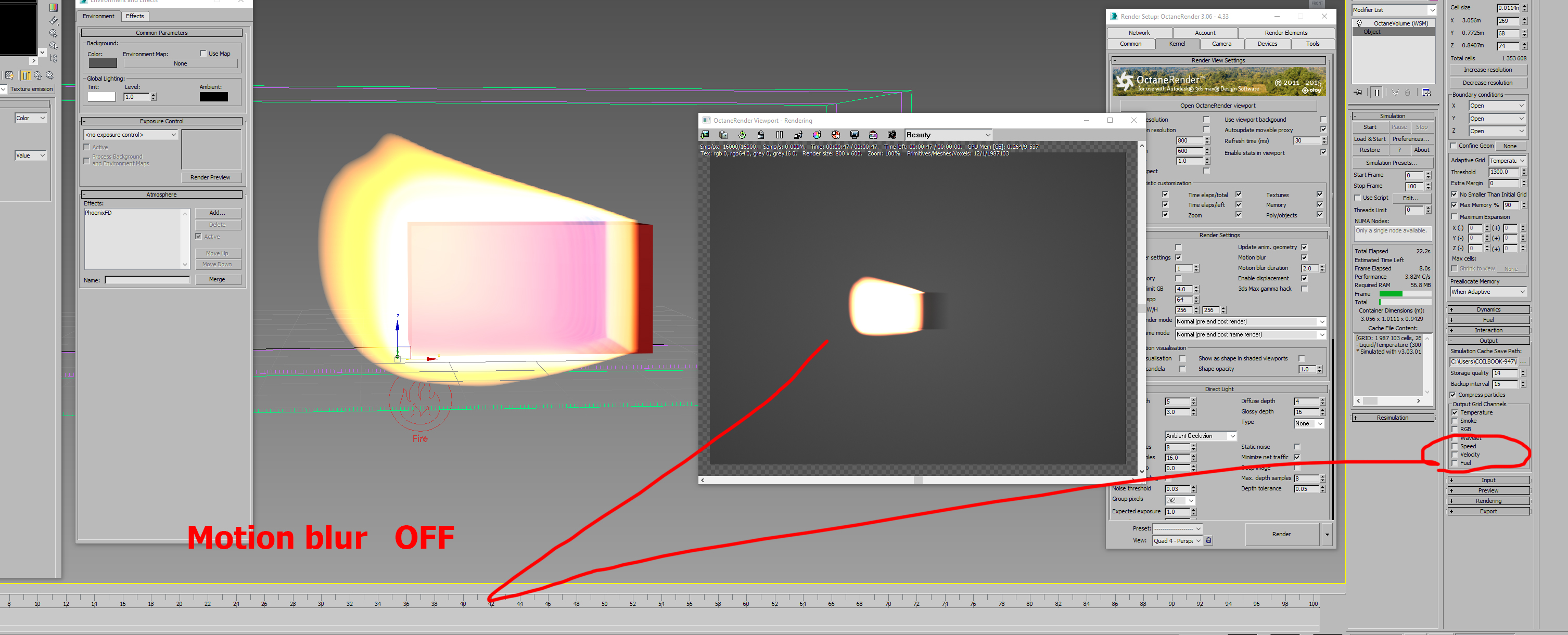

attached is the file. You can simulate yourself or use presimed vdb that is in the folder. Just go to frame 2 where box is moving fast and you can see that mb does not work for flames. Output velocity is checked. PHX Source Motion vel is also enabled, Enabled movable proxy and mb in octane properties for the sim grid. And still no difference
Enabling vertex mb makes it look all dark and strange. Like it does not work properly.
thanks

maybe it does work with vertex mb enabled but why so many grainy particles are created when vertex mb is enabled. is this how fire looks at high speed

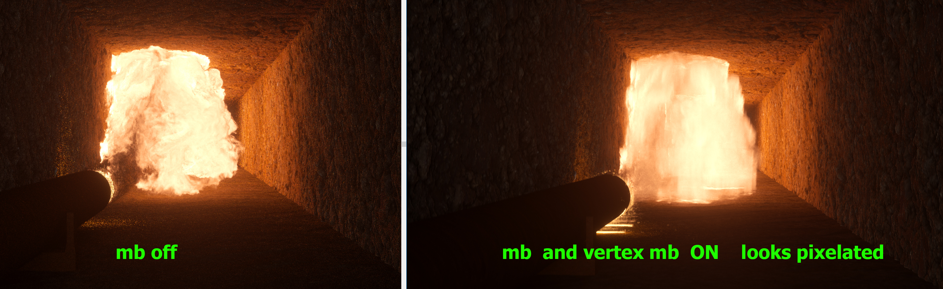

here mb and vertex mb are ON looks strange but maybe that's how mb looks for flames?? Flames are traveling away from camera at high speed

Hi coilbook,
I checked your issue, made a report and sent it to developers.
About "pixellated" effect, it would be a question about density (screenshot)
did you try to adjust it by changing volume medium density value and phoenixFD grid too? (I know you asked this in another post and I'm investigating it around).
