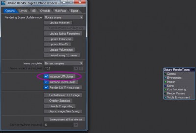

The problem can be also related to the "instance LW clones" feature. With this option enabled (you have it in the render target root node options panel), all the LW clones are extracted as Octane instances, and all the instances must share the same base mesh. Probably disabling this option your scene could work fine without renaming the objects.
Thanks,
-Juanjo
promity
Posts: 363
Joined: Sun Dec 19, 2010 7:59 am
Location: Russia
Another method. Turn off 'Instance LW clones'.
