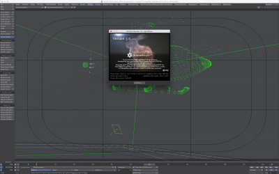

When I open the Octane plugin options and set the path to the TFD plugin
(/Applications/NewTek/LightWave3D_2015.3/support/plugins/TurbulenceFD_LW_v1-0_1416/TurbulenceFD_1416.plugin)
there is no "TFD_loader_64.p" file, since .p files are a Windows only plugin type.
On OS X the plugin is called "TurbulenceFD_1416.plugin".

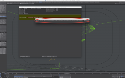

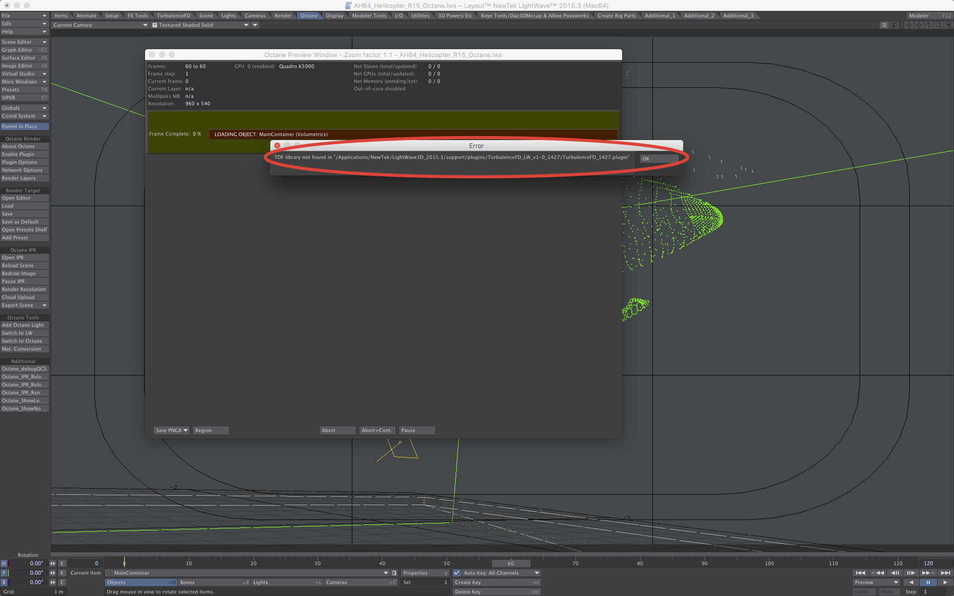

But using that path, IPR crashes every time, and if I try to do a frame-render F9, I get the error message,
TDF library not found in "/Applications/NewTek/LightWave3D_2015.3/support/plugins/TurbulenceFD_LW_v1-0_1416/TurbulenceFD_1416.plugin"

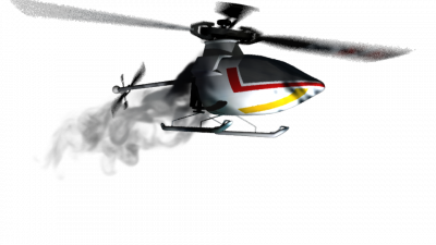

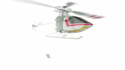

The frame-render then proceeds and I get everything rendered BUT the TFD effect.

The Octane for LightWave 3.06.4.0 plugin just released today is not built using this 1427 TFD API (I didn't have it yet when the build was done), so perhaps the plugin can't work with it. In this case, please let me know to release a new plugin build of OSX.

Thanks for getting this fixed. But as you suspected with this today's released version of the plugin, it still gives the same error:
