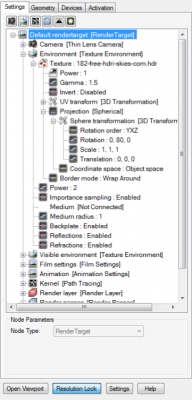

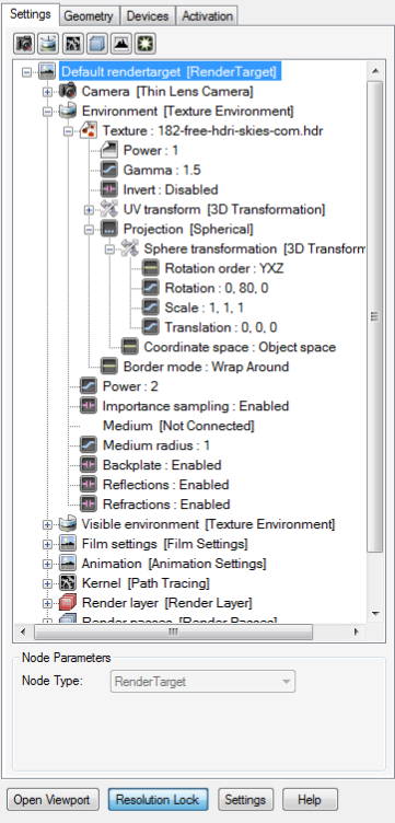

Can you post a screenshot of the Environment Image node tree settings so I can see the projection that is being used?

Hi Paul
the release is 3.6.5.82.VR
bye
face_off
Posts: 15767
Location: Adelaide, Australia
Hi - there was a fix in Octane 3.06.1 for this problem. So pls try with 3.6.1.83.VR.
