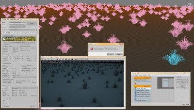

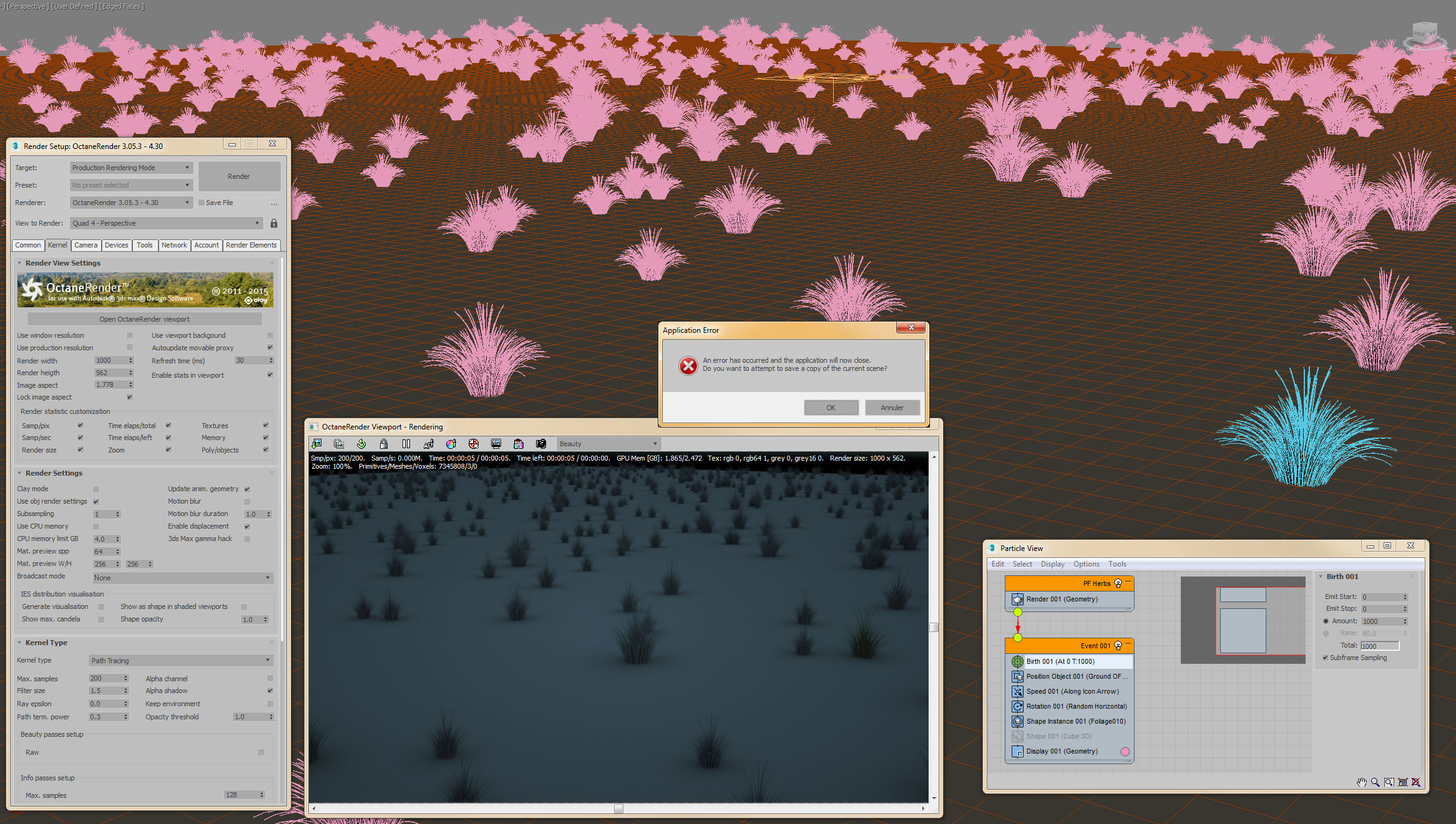

I have a simple plane on wish I scatter a meshes (7000 faces) using particle flow.
Each time I set particle birth to more than 1500 instances Max crashes when opening OctaneRender viewport (or launching a render).
I think 1500 instance is not a big deal for particle...I would need 10 000 + instances in this scene...
Is it a memory issue?
Is there a way to instance the meshe?

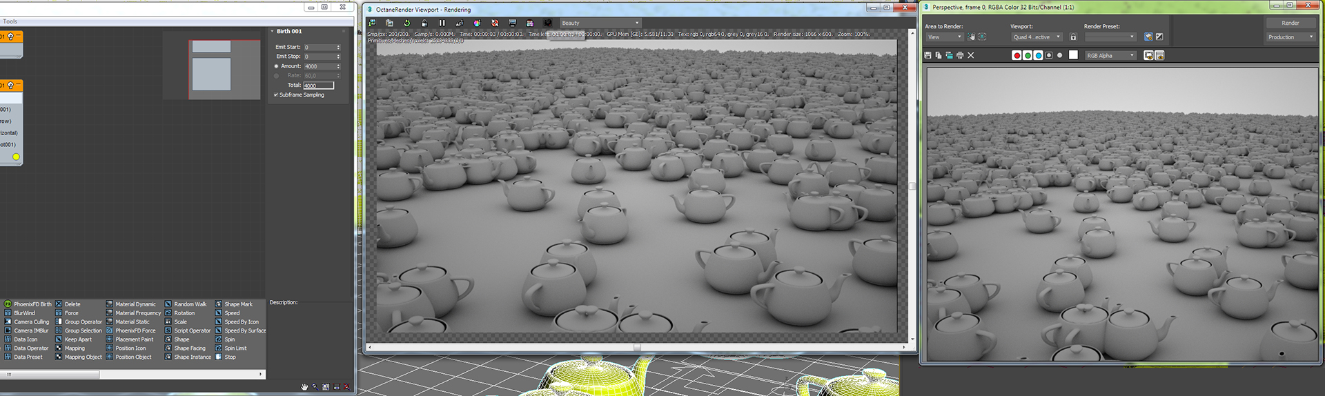

Sorry for posting so late, I was off for a few days.
Here's a scene.
A simple Pflow scattering teapot on a plane.
It renders with Birth set to 2000.
If I raise the birth to 3000 it crashes.
Seems to be a memory issue...

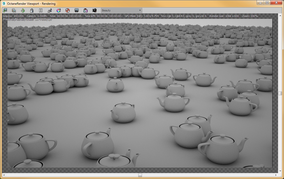

When redering with 3000 particle, the task manager indicates that Ram stays under 20 Go usage over 24 Go total.
So it's not a Ram limit problem I guess.
Also what is strange is that the octane viewport indicates 4.794 Go available VRam.
Shouldn't it be 6 Go available as only the GTX980ti is active?
