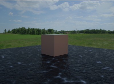

How to soften hdri texture based shadows?? , I`m using 22EV .hdr.

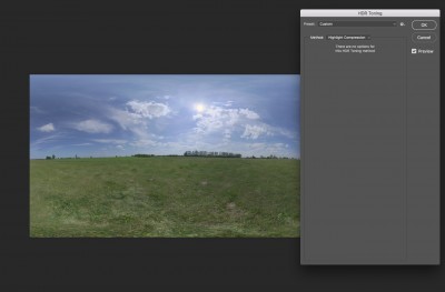

a possible solution is to open the HDRI in Photoshop and use the HDR Toning window to compress it.
Here is a fast and exasperated example with the Highlight compression preset:
before
before
toning in PS
toning in PS

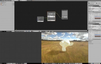

back to Octane
back to Octane

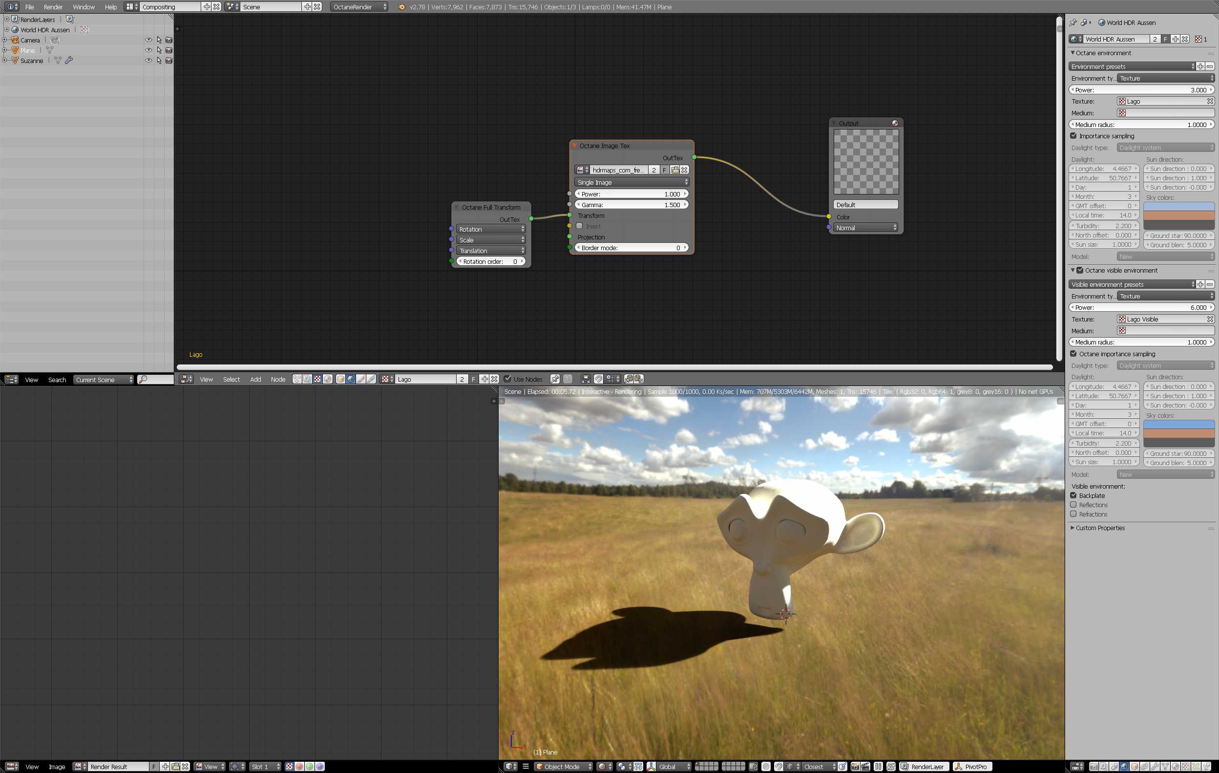

I'm not shure if that attempt ist what you need, but you can play with the gamma settings of the hdri.
Activate the Octane Visible Environment and make a copy of environment texture node in Order to keep the background appearance.
Same Settings Octane Environment and Octane Visible Environment
Increased Gamma Settings Octane Environment
