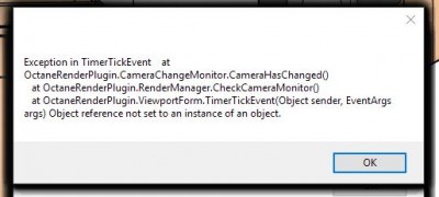

I'm also seeing a TimerTickEvent error (see attachment) when Octane starts rendering. If this error occurs, Revit crashes.

Would it be possible to send me the .rvt file pls? I need to determine if it's a specific issue with that file, or a general bug that has been introduced to the plugin. Those errors are indicating there is a problem with the Revit Camera/View.

I have investigated this issue, and it is a corrupted Revit View or sun settings. About 50% of the time, even without Octane loaded, just selected the views which cause this error will lock up Revit. So there are issues with those Views, and they should be recreated. I have added some checking in the next release of the plugin which will notify you of this problem.
