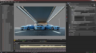

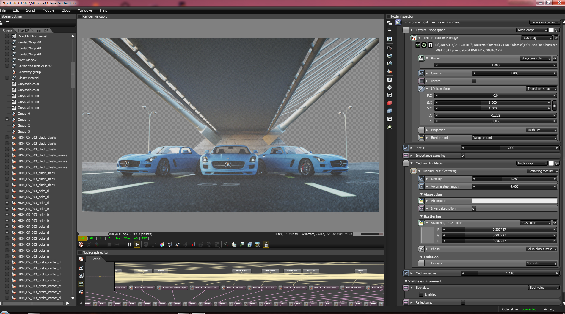

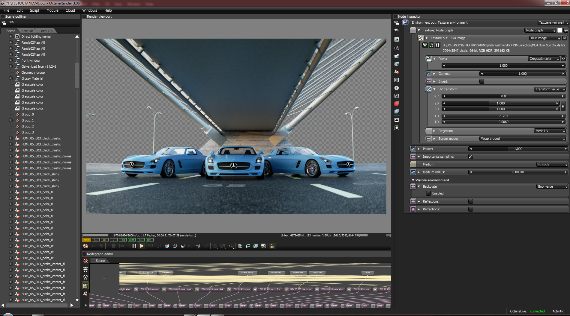

Can you tell me if this problem is known and if there is a sollution? Problem With STandalone and C4D Plugin.
HDRI or SUn / SKY lighting Octane the problem is the same, the MAIN layer remains transparent.
Thanks in advance.
see this:
Medium+alpha channel
and this:
No_MEDIUM+alpha channel

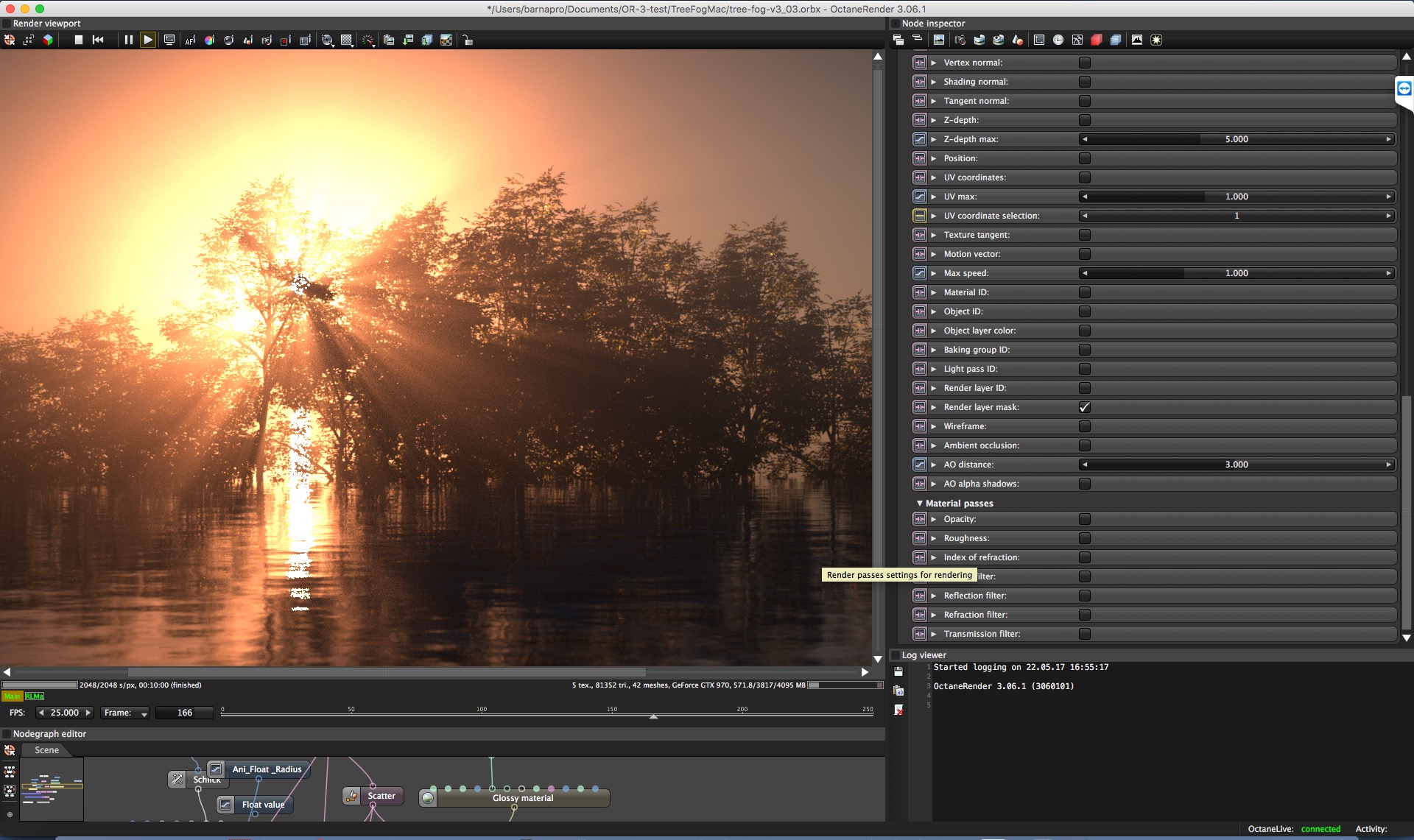

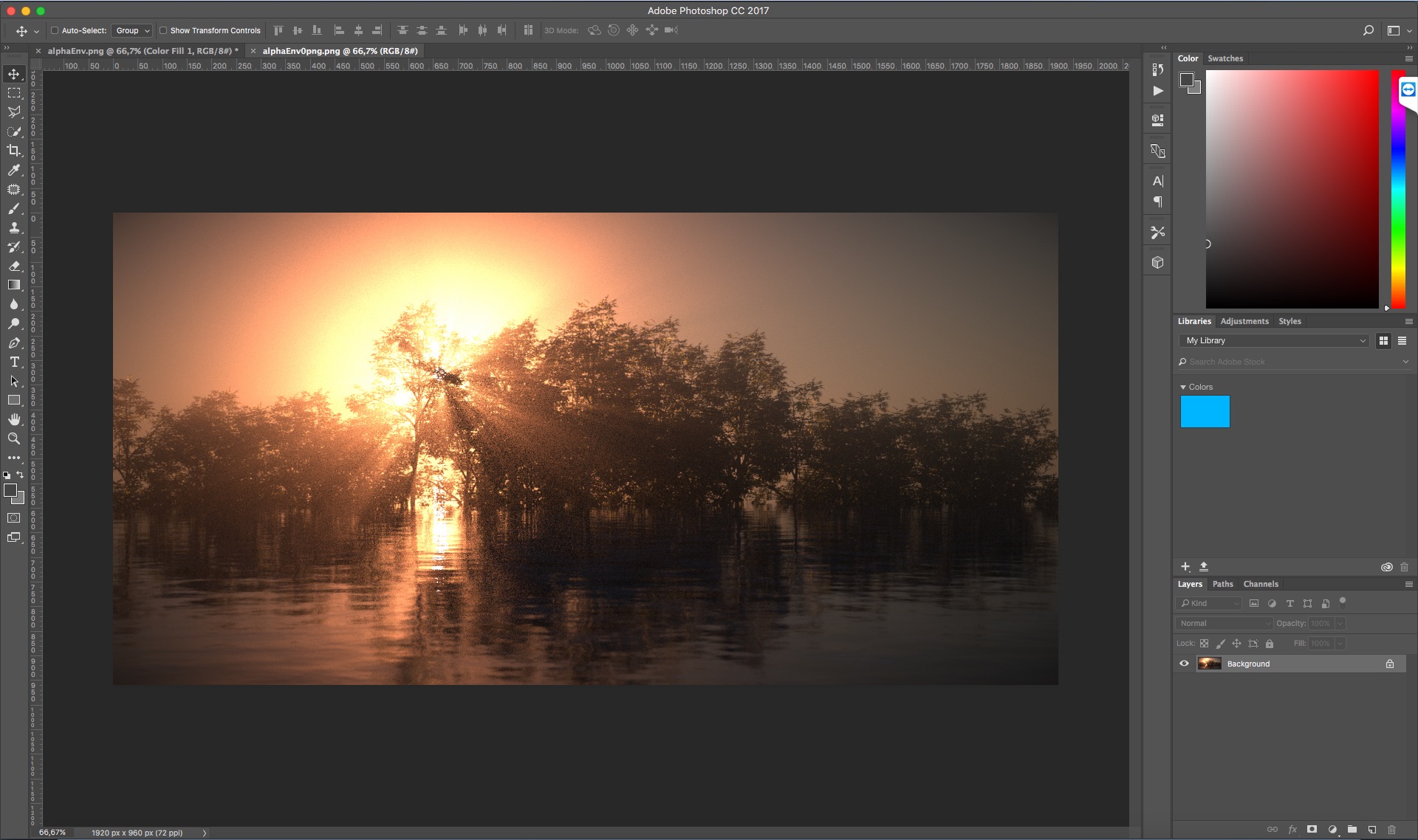

it depends on what you need at the end.

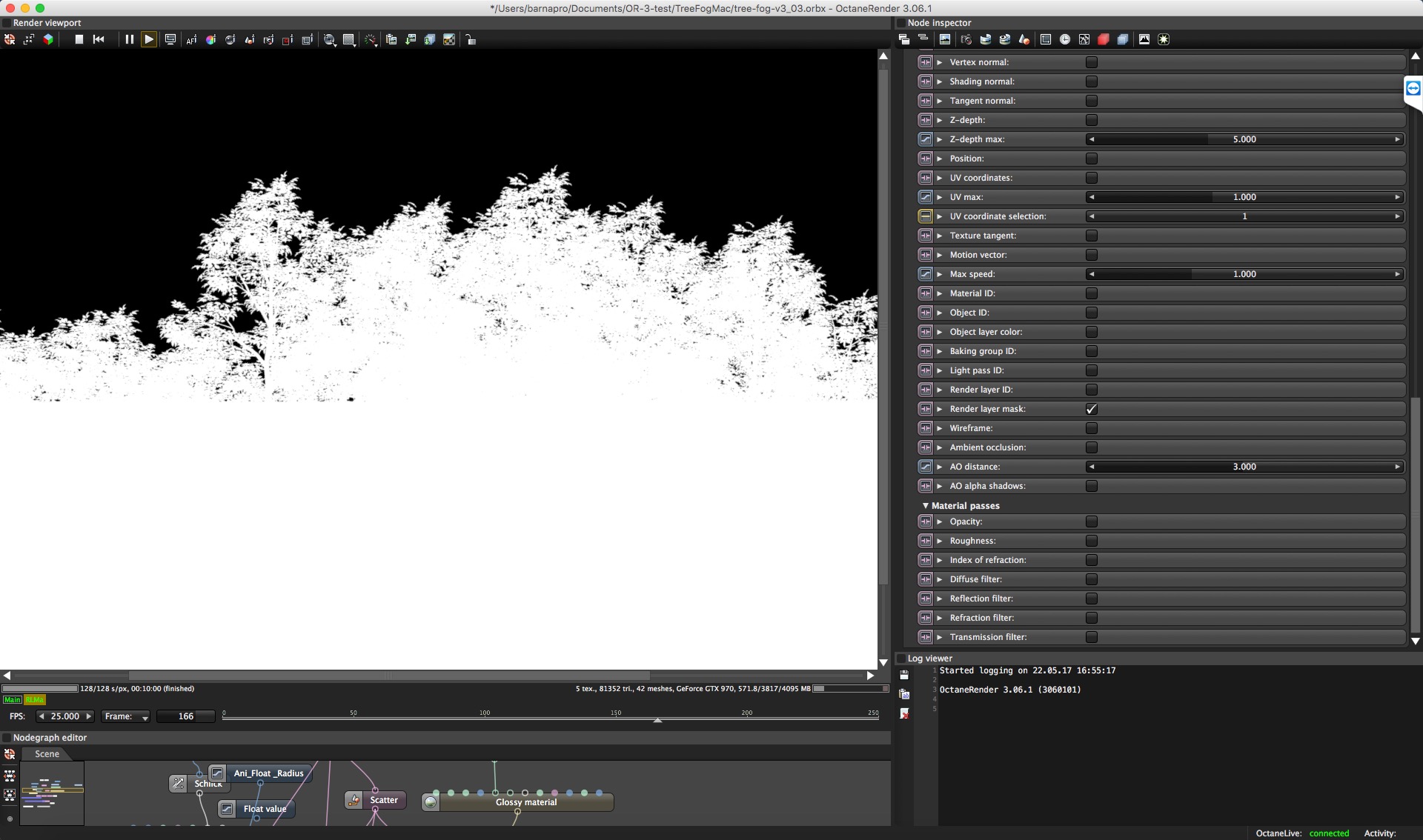

You can render without Alpha channel and obtain the alpha mask by enabling the Render Layer Mask pass:
beauty
beauty
Render Layer Mask
Render Layer Mask

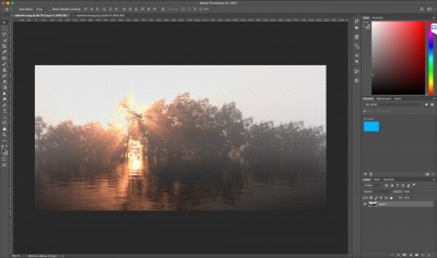

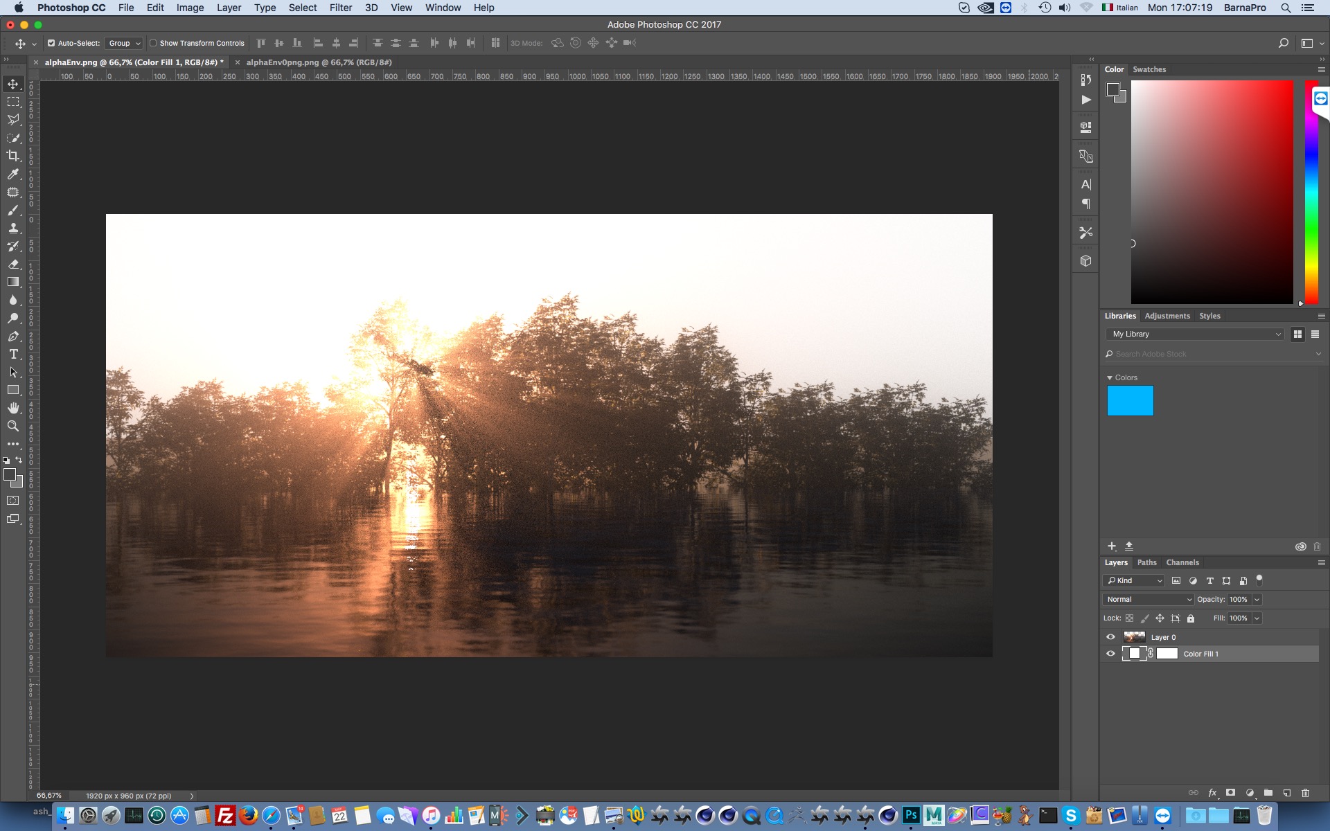

Or render with Alpha channel active and add a white layer behind the beauty pass:
beauty
beauty
beauty with alpha
beauty with alpha
beauty + white layer
