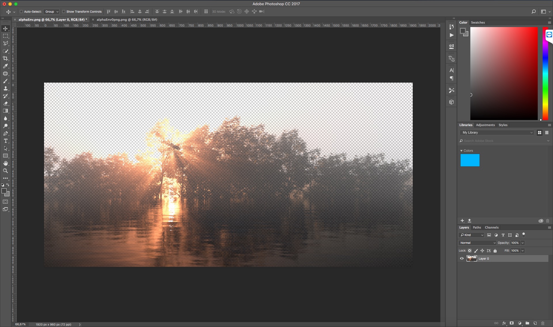

Can you tell me if this problem is known and if there is a sollution? Problem With STandalone and C4D Plugin.
HDRI or SUn / SKY lighting Octane the problem is the same, the MAIN layer remains transparent.
Thanks in advance.
see this:
and this:
OCTANE STANDALONE 3.06 | Win7/64 | 2XGEFORCE GTX1060|or GTX1080| I7 3770 | 32GB
Alpha Chanel and Medium high problem
Hi visuall,
it depends on what you need at the end.
You can render without Alpha channel and obtain the alpha mask by enabling the Render Layer Mask pass: Or render with Alpha channel active and add a white layer behind the beauty pass: ciao beppe
