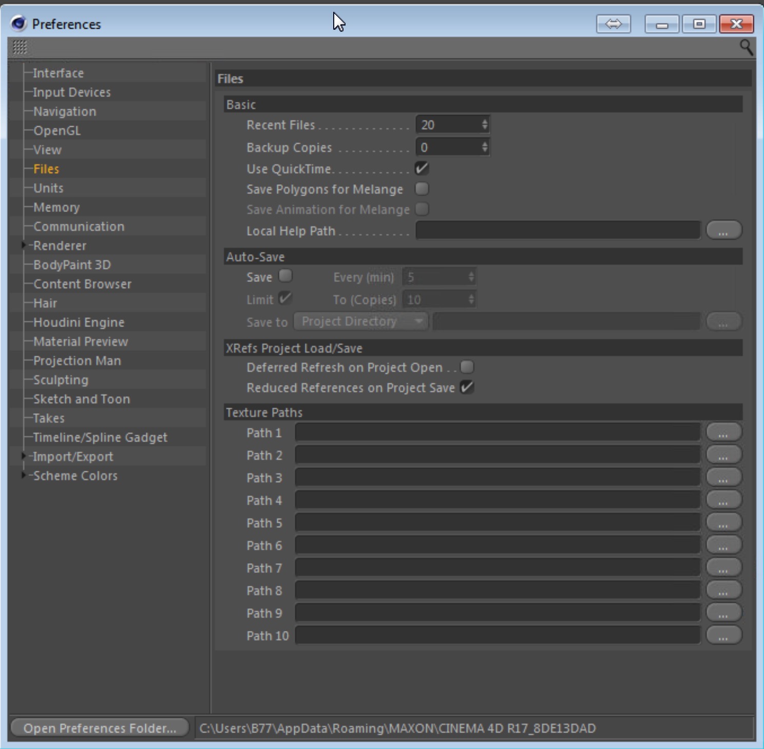

Posts: 10621
Hi Christoph,
we are at version 3.06 now:
viewtopic.php?f=85&t=60816
About the freeze, do you have any special path in the c4d texture preferences, like network paths?
ciao beppe

Christoph_Strohfeld
Posts: 5
Joined: Wed Sep 30, 2015 7:45 pm
you are genius!!! I had there a path going to the server. So when i added just a image texture it already started looking there!!
Thank you so much!!
