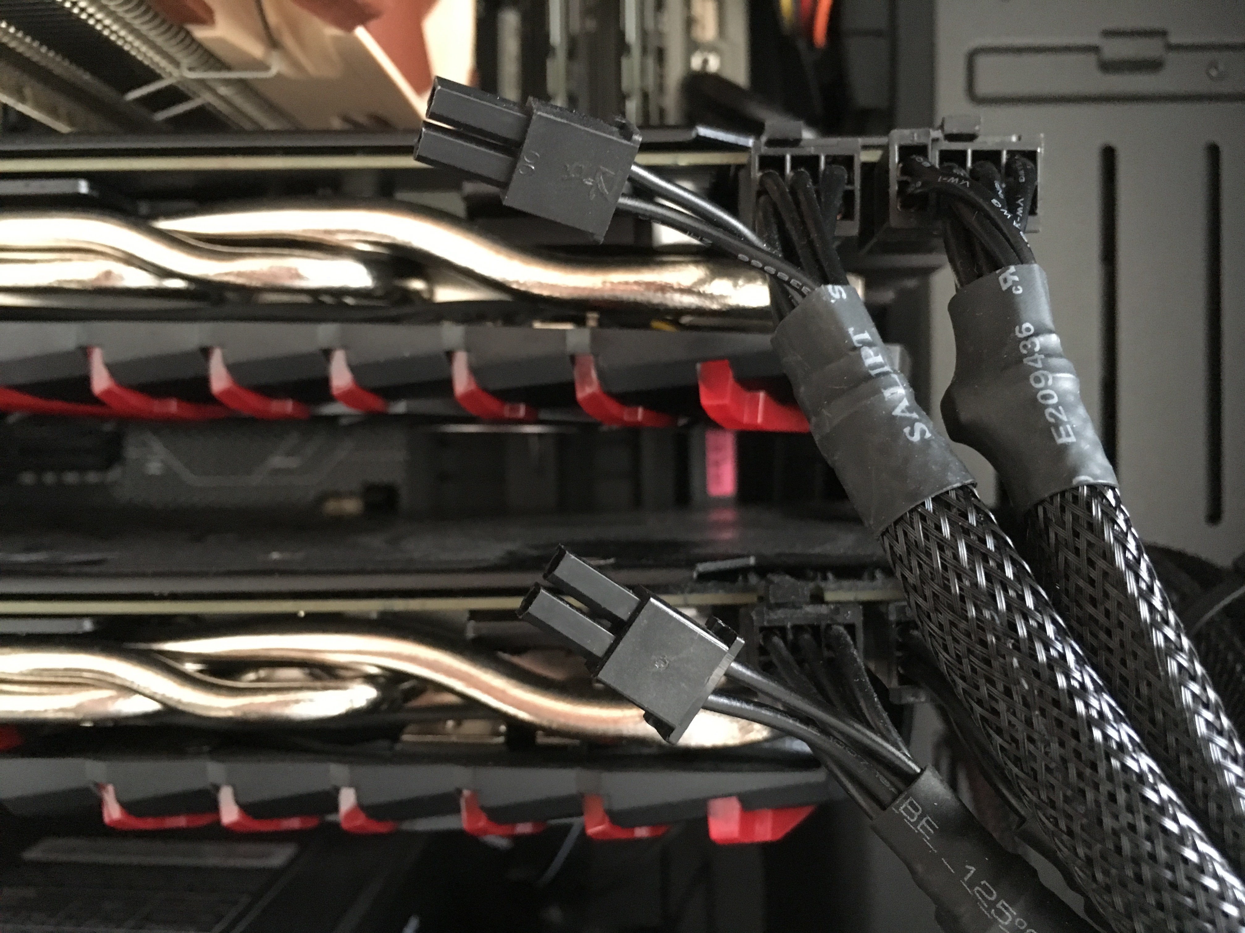

Darkpulse
Posts: 9
Joined: Wed Jun 24, 2015 8:12 am
bepeg4d wrote:Hi guys,
I wonder if it's not related to the power connections of the cards... how are you powering the gpus exactly?
ciao beppe
My two MSI GTX 1080 are connected like the attached picture. Connected respectively to PCIe1 and PCIe2 PSU ports.
Posts: 10597
Hi guys,
sorry, I mean which kind of power supply?
In general kernel panic and restarts are hardware related, like thunderbolt port of power supply issues.
ciao beppe
