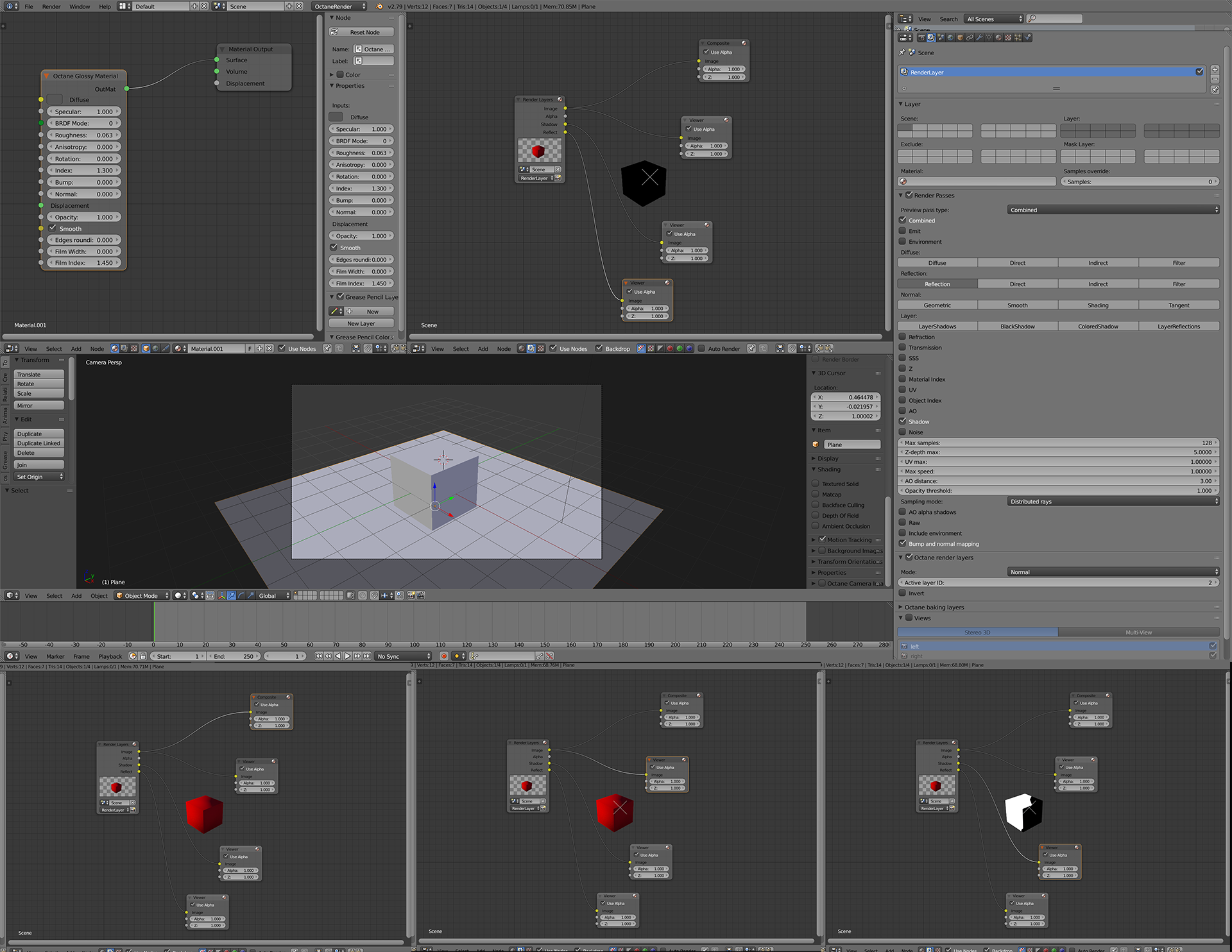

Check the attached blend file, Its a simple cube as object and plane as the shadow catcher as well as the reflection catcher.
Just render the file and check the viewer output in the node editor.
I use fusion but any compositor will do.
The attached images show both the shadow and Reflection as well as the Z-Depth Pass in actual use in an ongoing project,
I hope that helps.

This works perfectly, Rajiv - thank you so much for taking the time.
[I've also updated to 11.24 from 11.21, as per your advice on DM, which solved the reflections problem]
