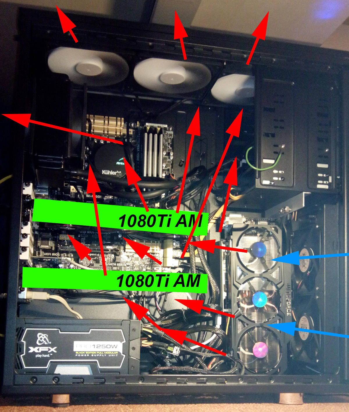

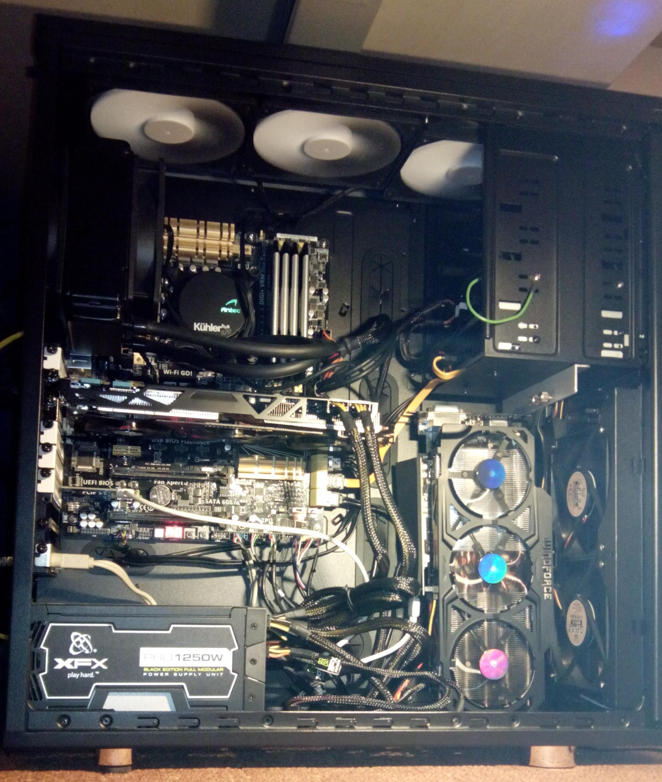

Need a little advice about upgrading my GPU WS (see pics)
Got 3x780Ti; 1 display EVGA in 16x slot and 2xGigabyte on risers (down/right)

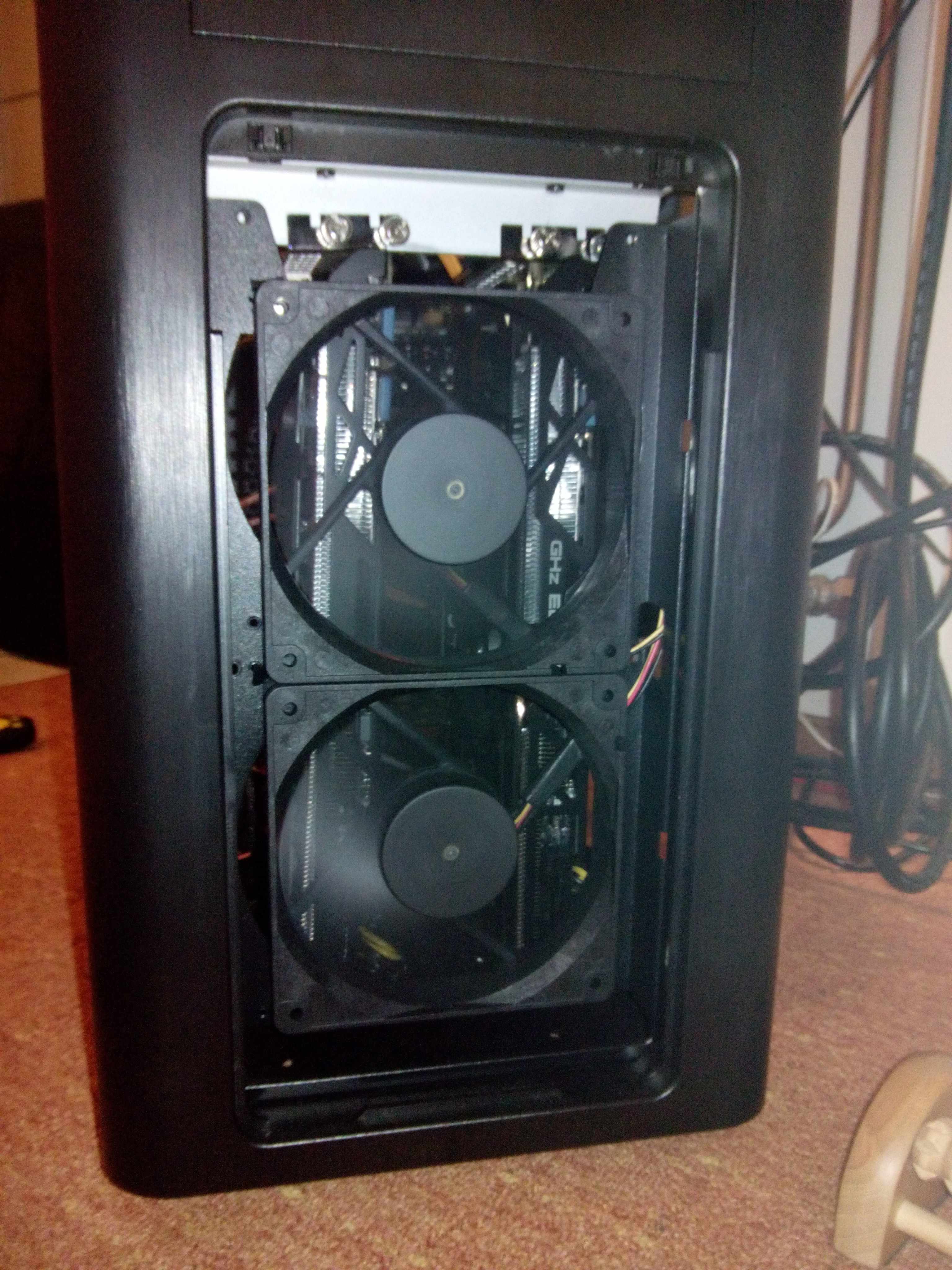

Down right I got 2 intake fans blowing cold air over 2 cards on risers and 3 outtake fans (up) pulling hot air out.
My temps on full load are 73C max for EVGA and 65C max on 2xGigabyte.
Now I would like to upgrade my WS with one 1080Ti and make it main GPU and move EVGA 780Ti to riser next to those 2 GPUs down/right.
Maybe later purchase one more 1080Ti and insert it in 16x slow at MBO bottom (MBO is Asus Z87-PRO).
So, regarding airflow what would be your advice, to buy founders edition (air intake) or after market GPU with 3fans?

Also, on upgraded rig with 4/5 gpus, should I maybe consider reversing airflow, 3 upper fans intake and lower/left 2 fans outtake?

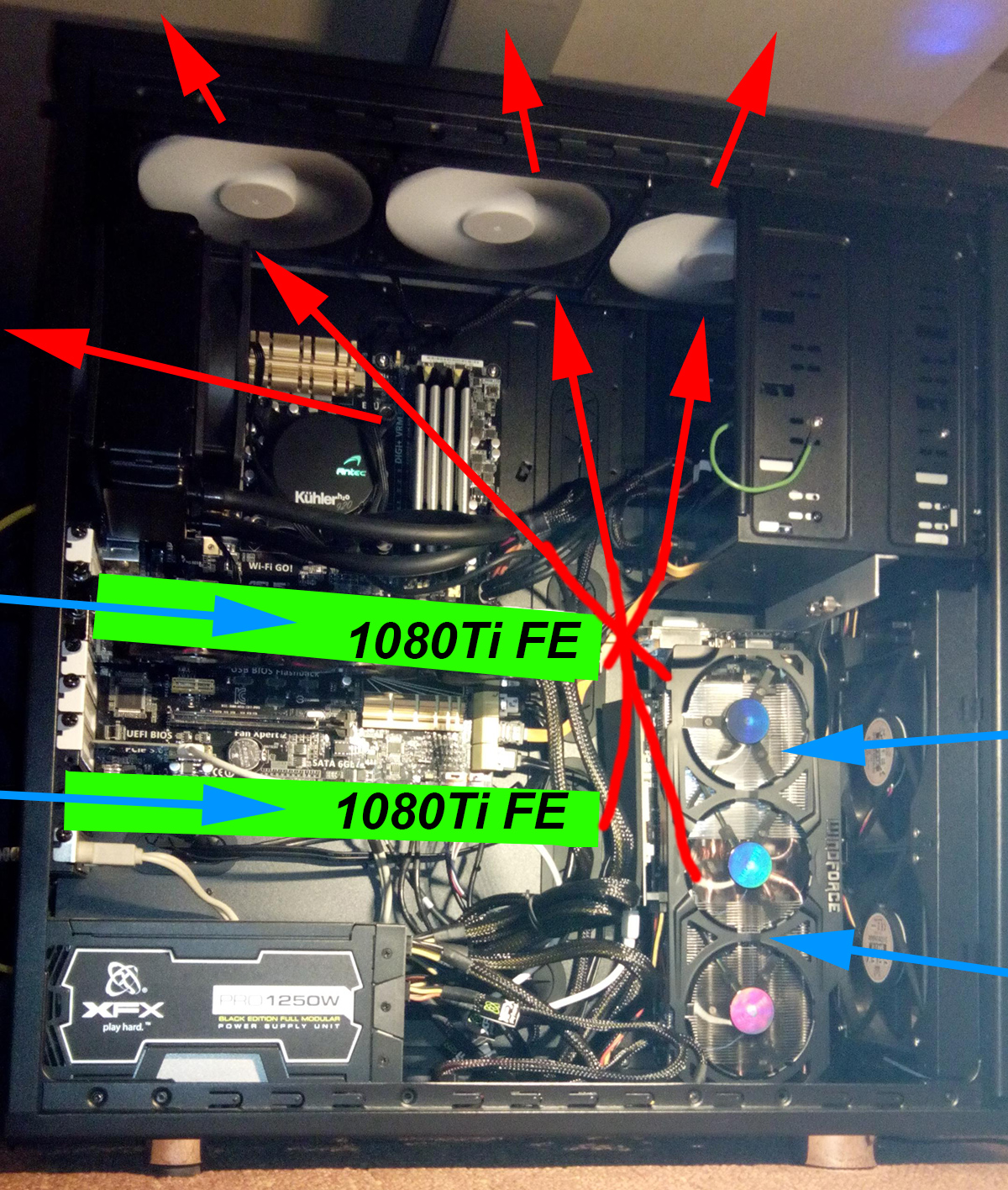

I was interested in AM models but saw comments that Founder Edition is better for packed rigs because of air intake.
So if I got AM model they would pick hot air coming from those cards on mount.
FE models would intake cool air from outside, like in pic bellow.
