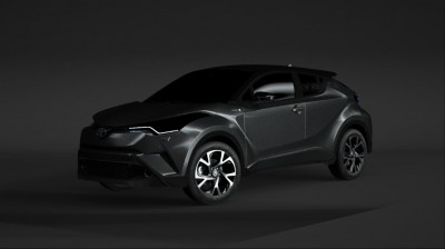

I'm rendering out a studio car shot and the shadow catcher is reporting dark.
It's lit with two area lights and a HDRI. I have a background image loaded and Alpha Channel checked.
When I use the Modo shadow catcher option I get the exact same result.
Any answers?

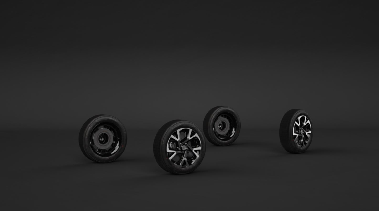

Well the plot thickens...
I turned off the folder containing the body of the car and this happened.
Shadow catcher is working as I'd like it to.
What gives Face_Off?
I'll turn off meshes one by one and see if it's a material tag or something.

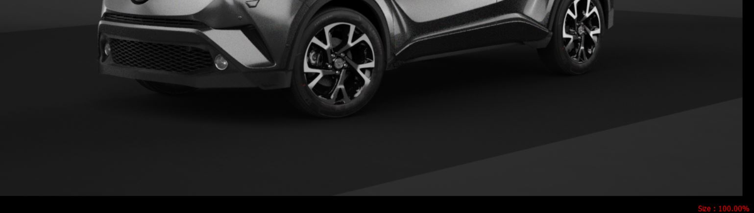

Okay I've zeroed in on the problem.
I have the headlight assembly turned off and the shadow catcher works like it should.
The left light assembly is geo, and the right is instanced.
I turn off the meshes with blackbodies attached to them (lights) and the shadow catcher works... turn them on (make visible in the item tree) and the shadow catcher gets busted.

If you export this scene to ORBX and then submit it to Otoy in the Octane 3.06 Standalone release thread, the Otoy devs can investigate.Okay I've zeroed in on the problem.
