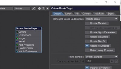

Okay- got it to update in IPR by ticking the "Volumetrics IPR update" checkbox in Plugin Options. But still no love in the F10 render seq. still renders first frame of cache. Anyone with an answer please help:)

Full scene reload mode fixed the "first cache frame only" problem... now on to how to make the volume look good:) Sometimes it helps to post with myself i guess:)
