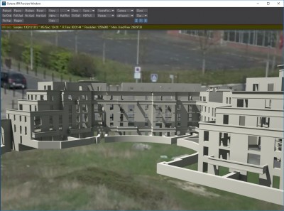

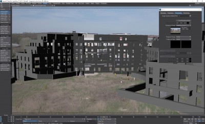

Hi JuanJo,
I've a problem with image sequence size. Incorporate 1920X1080 in Backgroung Image to compositing image in LW, Scale is OK !
Incorporate same sequence in Octane, the scale is to big ! Any idea please ?

BorderLine
Posts: 292
Joined: Sun Mar 24, 2013 5:30 pm
JuanJo,
I've a big problem with image sequence ! Must calculate with Alpha for seeing Image sequence background and saving with png sup my backgroung !
How can i save my animation in jpg frame ?

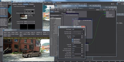

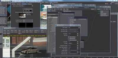

Alteris3D
Posts: 36
Joined: Wed Aug 31, 2016 8:03 pm
I think I know you're problem. You have a image set up in Background composite in Layout and texture environment in your Octane Render target editor, correct? Just be sure to check "Alpha Channel" in your render target kernal, and you will see your background image from the "Effects-Compositing" Tab.
Alpha Channel Off
Alpha Channel On
Hope this answered your question!
BorderLine
Posts: 292
Many thanks Juan !
BorderLine
Posts: 292
Thanks Alteris3D,
Yes, it's my problem and i check Alpha but if you save your animation with Octane Render Passes, he sup the background what's i understand because i check Alpha. It's good to have jpg option in render passes because saving with output Lightwave not premultiplied alpha and i have a halo under object
