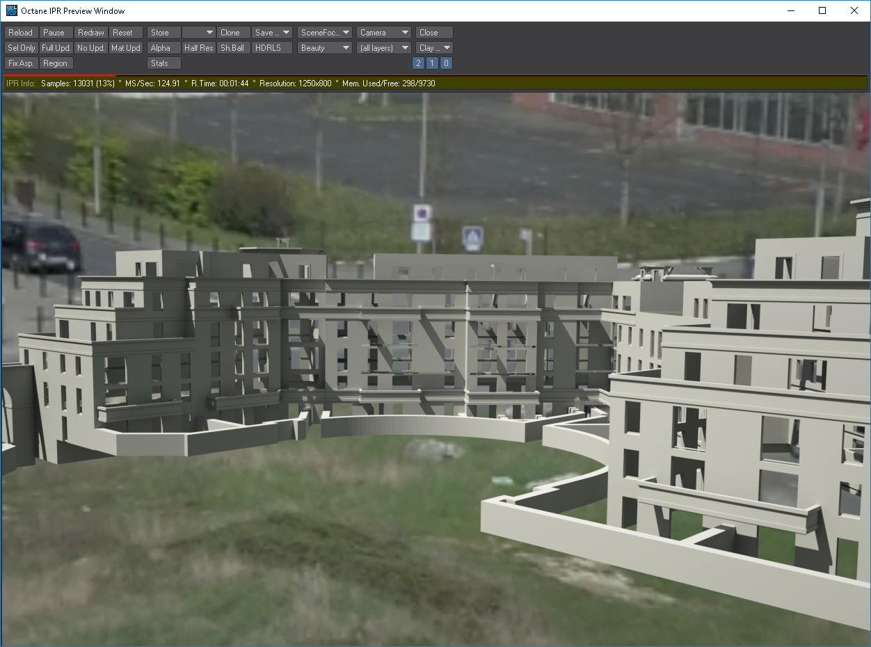

JuanJo,
I've a big problem with image sequence ! Must calculate with Alpha for seeing Image sequence background and saving with png sup my backgroung !
How can i save my animation in jpg frame ?
The background compositing is done by the plugin, it is not a native Octane feature, so it is only available if you save the images using LW image save functions (Render Globals, Output tab). You are not going to get the background if the images are saved using the native Octane passes saving functions. In this case, you must add the background in post.

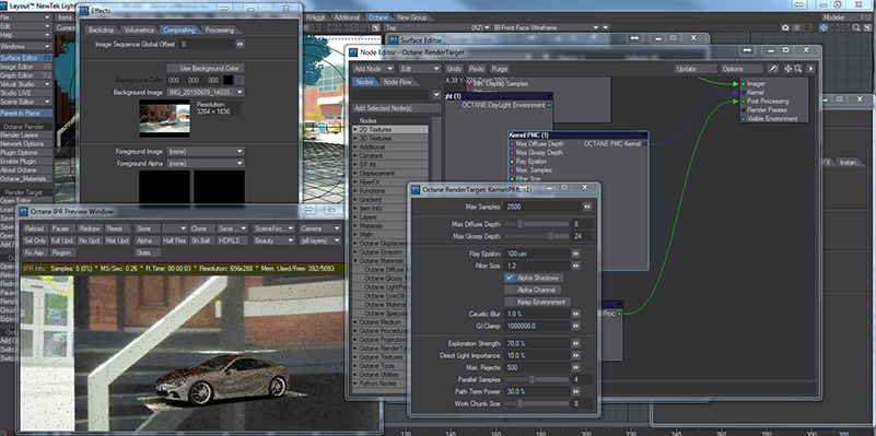

I think I know you're problem. You have a image set up in Background composite in Layout and texture environment in your Octane Render target editor, correct? Just be sure to check "Alpha Channel" in your render target kernal, and you will see your background image from the "Effects-Compositing" Tab.
Alpha Channel Off Alpha Channel On Hope this answered your question!

Thanks Alteris3D,
Yes, it's my problem and i check Alpha but if you save your animation with Octane Render Passes, he sup the background what's i understand because i check Alpha. It's good to have jpg option in render passes because saving with output Lightwave not premultiplied alpha and i have a halo under object
