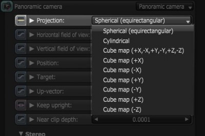

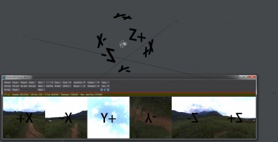

Hey Juanjo, take a looksee at these... Is it possible you did the cubemaps wrong in plug? According to Octane SA manual, it should go +X,-X,+Y,-Y,+Z,-Z.... and then look at my IPR, with my fancy +/- XYZ model...

If I point my camera at -Z, then save my six images in the correct order (+X,-X,+Y,-Y,+Z,-Z -- even though +X and -X show opposite of those sides I'm saving -- +X as -X and -X as +X), these seem to work correctly... So crisis averted. No need to look into anything J. I think I'm the only Octane guy doing WebGL crap anyway...
