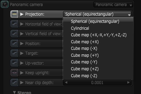

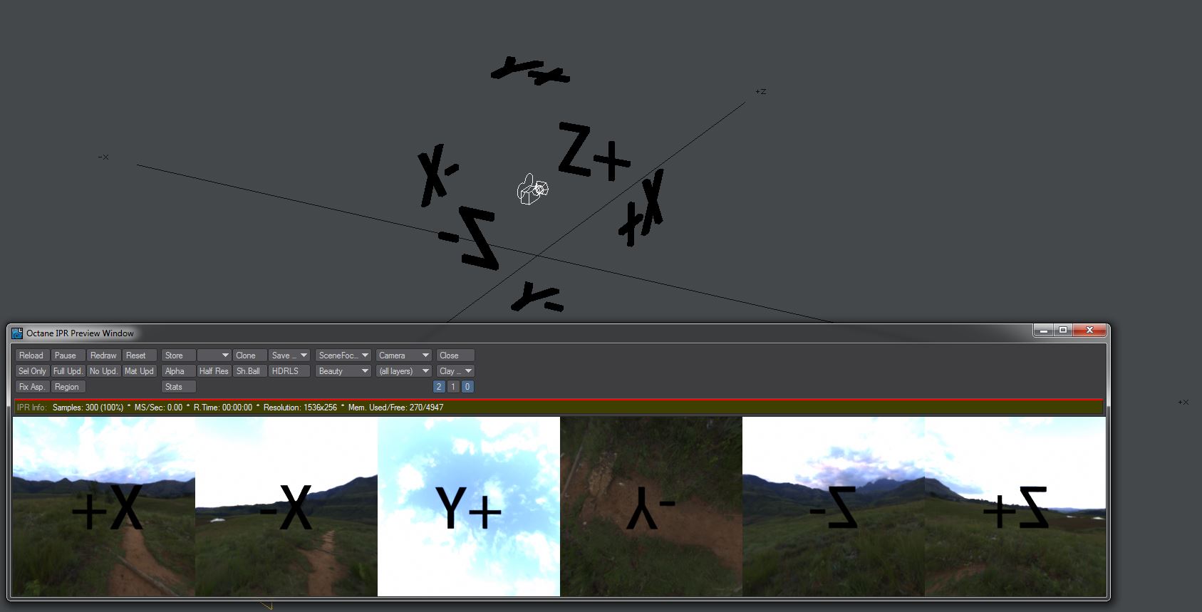

Hey Juanjo, take a looksee at these... Is it possible you did the cubemaps wrong in plug? According to Octane SA manual, it should go +X,-X,+Y,-Y,+Z,-Z.... and then look at my IPR, with my fancy +/- XYZ model...

If I point my camera at -Z, then save my six images in the correct order (+X,-X,+Y,-Y,+Z,-Z -- even though +X and -X show opposite of those sides I'm saving -- +X as -X and -X as +X), these seem to work correctly... So crisis averted. No need to look into anything J. I think I'm the only Octane guy doing WebGL crap anyway...

Yes, I'm not sure, but as you say the problem can be related to the camera orientation or scale. To be honest I think that I've never tested this feature ;)
