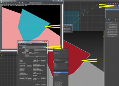

I try to assign ID to different objects in the scene but I allways obtain the same multicolor image whatever I do (using Max 2014).
I tried assigning different object IDs or different Material IDs.
And I tried rendering with info channel or with render elements.
Allways obtaining the same multicolor image...what am I missing??

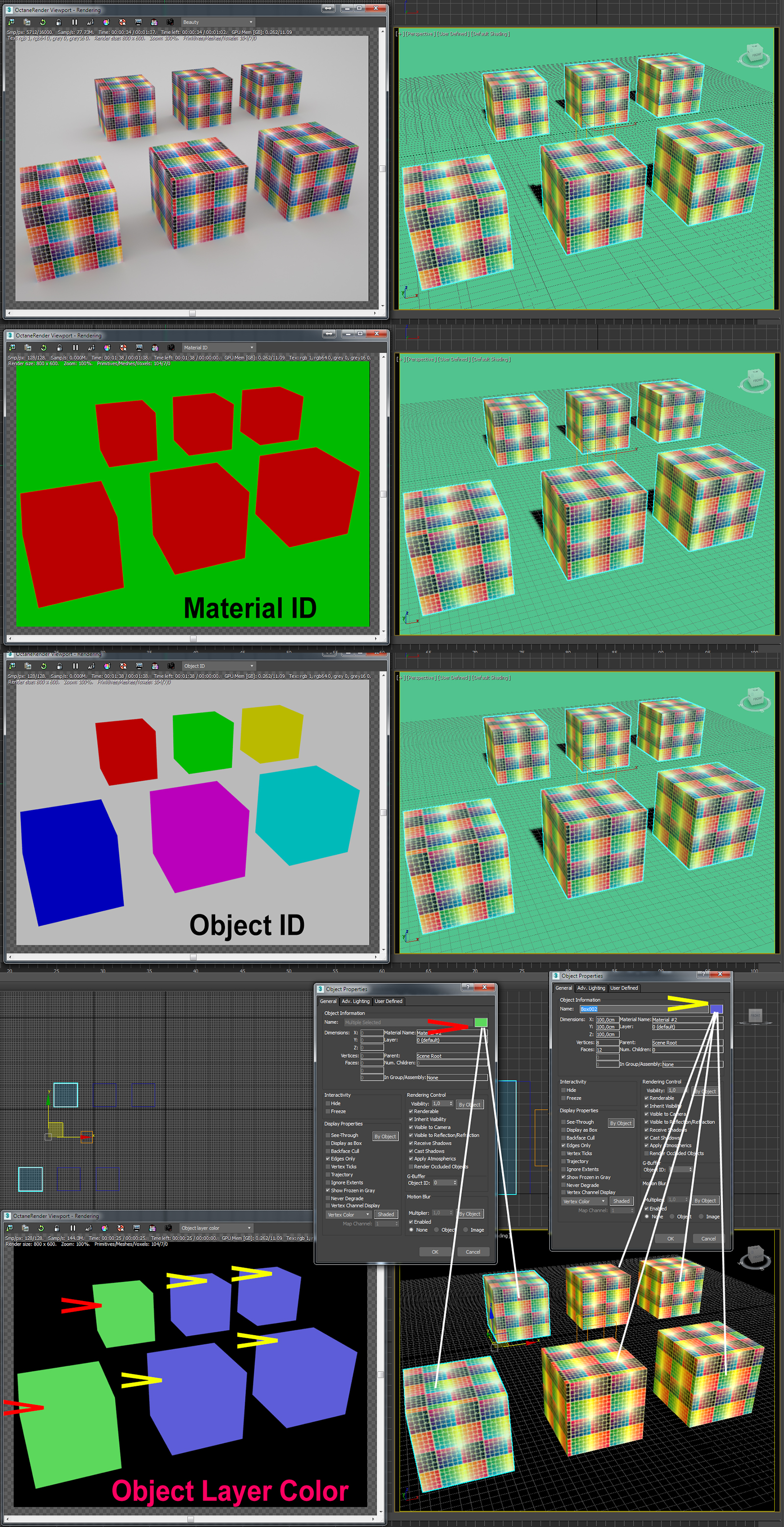

Octane redner automatically assigns colors for iDs.
If you want to customize the colors you have to use Object layer color.

Object layer Id randomly assigns an object color, something like a VRayWireColor.
If you want to assign a precise color you have to use Object layer color.

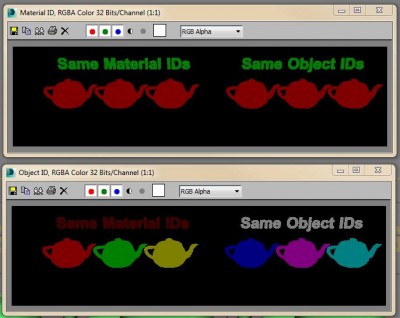

Sorry I really dont understand how to use the ID...
Here are the 2 pass of a scene.
All objects on the left (including text) have the same Material ID
All objects on the right (including text) have the same object ID
As you can see the rendered pass are not logical :
same ID should be the same colors...
That doesn't take (mat or object) IDs into account.

Object layer color is in info passes, It's a new features implemented after 4.21 (that you are using).
Regards
