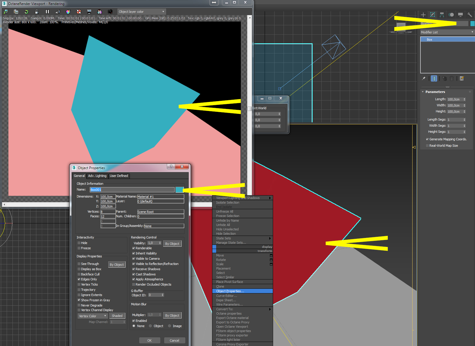

Hi Fabrice,
Object layer Id randomly assigns an object color, something like a VRayWireColor.
If you want to assign a precise color you have to use Object layer color.
Regards
Paride

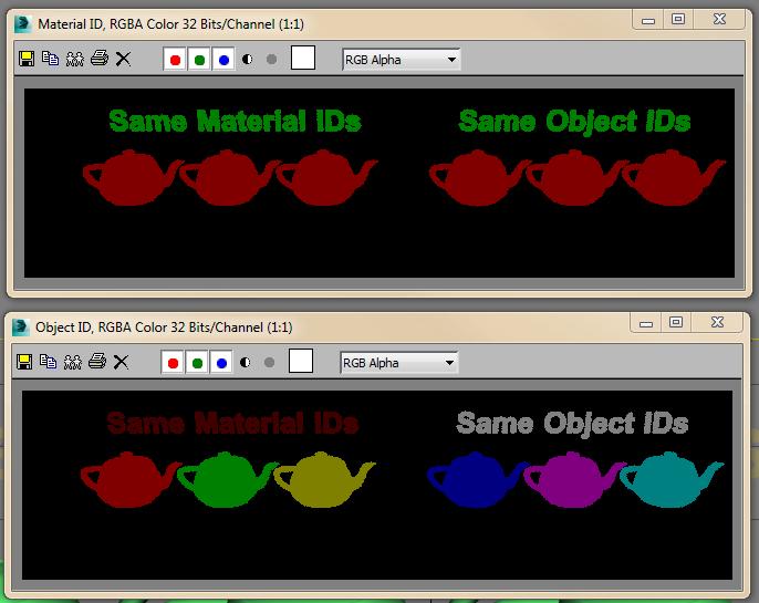

Sorry I really dont understand how to use the ID...
Here are the 2 pass of a scene.
All objects on the left (including text) have the same Material ID
All objects on the right (including text) have the same object ID
As you can see the rendered pass are not logical :
same ID should be the same colors...
That doesn't take (mat or object) IDs into account.

Hi Paride,
still struggling with IDs...
- Object ID pass still doesnt work (ie the scene I uploaded).
- What is "Object layer color" ? I cant find it neither in "render elements" nor in the "info channels"

Hi Fabrice,
Object layer color is in info passes, It's a new features implemented after 4.21 (that you are using).
Regards
Paride
Regards
