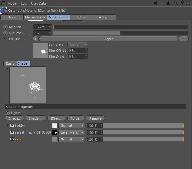

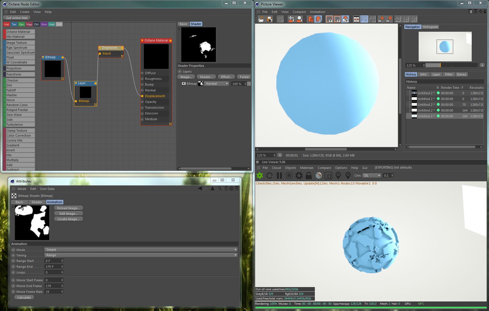

I'm trying to animate a displacement mix using the layer shader. Everything works great in the live viewer, but final renders have no displacement at all.
I've tried different shaders (bitmap(c4d) and ImageTexture(octane)) but ImageTexture does not allow me to animate the sequence (imagetexture sequence works now), despite trying many ranges. Bitmap works just fine though and I use the same sequence in a few places without problems.
Layer Shader

Live Viewer (as expected)
Live Viewer
Live Viewer
Final output in Picture Viewer
Picture Viewer
Picture Viewer
Any ideas?
Thanks!

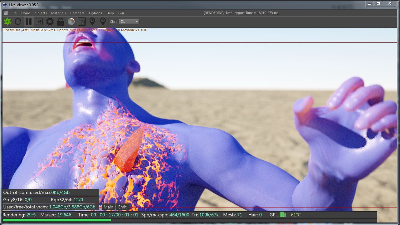

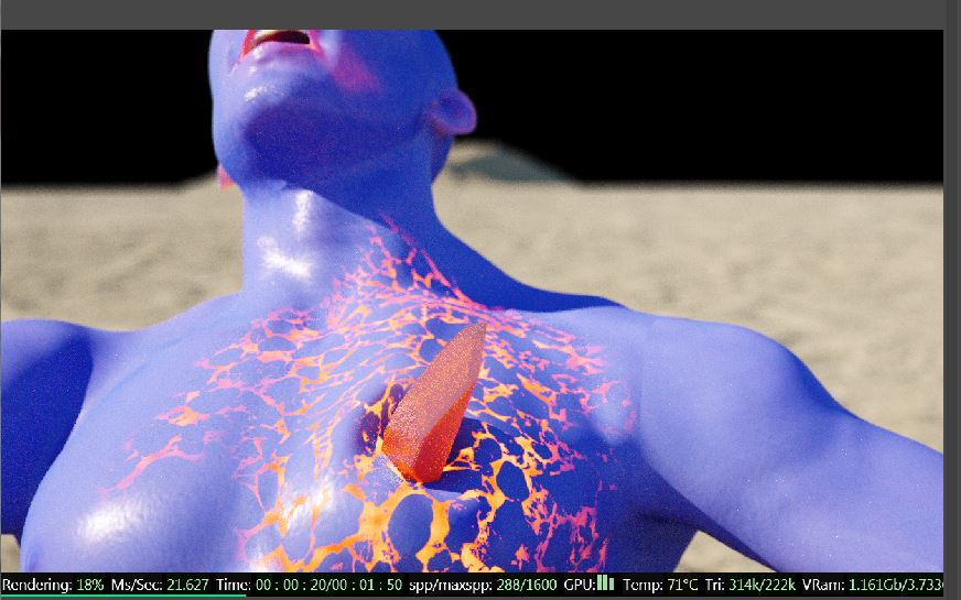

I had a similar issue to you, except I wanted layered animated c4d noise to drive displacement in an octane shader; I solved it by doing the following;
Figured it out if anyone's curious - toggle resend all scene data in octane render settings :) also added a bunch of keyframes to the animated textures and an octane object tag to displaced object.

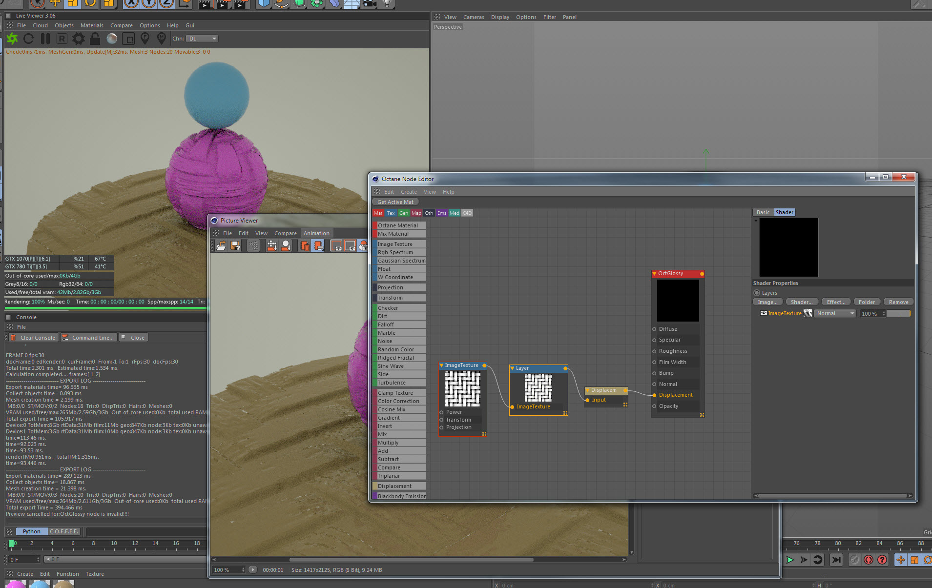

aoktar, the imageTexture does work, but it does not progress the image sequence like the bitmap shader does when inside of the layer shader. So if my sequence is image_000.jpg to image_120.jpg, I only get the displacement from the frame that I loaded, and not the rest. I can set the animation range from frame 0 to 120, and it only displaces according to the image I loaded in (frame image_050.jpg for example). The Bitmap shader on the other hand does progress the image sequence correctly every time, but then does not displace in picture viewer at all :), It's like they both only do half the job hehe.

Rev wrote: aoktar, the imageTexture does work, but it does not progress the image sequence like the bitmap shader does when inside of the layer shader. So if my sequence is image_000.jpg to image_120.jpg, I only get the displacement from the frame that I loaded, and not the rest. I can set the animation range from frame 0 to 120, and it only displaces according to the image I loaded in (frame image_050.jpg for example). The Bitmap shader on the other hand does progress the image sequence correctly every time, but then does not displace in picture viewer at all :), It's like they both only do half the job hehe.
Do you think the layer shader interaction will work better in future versions?
Things are much harder to get worked than estimations. All of those, C4D shader's evaluations are big pain in codes. I couldn't get this worked better. Also going to this way is like using a ferrari on first gear. Correct way to use octane shaders, i know displacement is very limited. I think guys will bring a rasterizer node and it will solve a lot problems here. So we can rasterize any octane texture and use in displacement. Also with 3.1 we will have OSL version then we will have possibilities to re-write any shader in Octane side.
