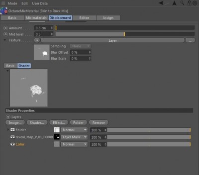

Layer Shader

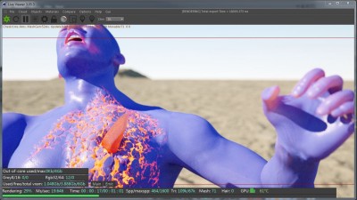

Live Viewer (as expected)

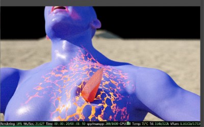

Final output in Picture Viewer
