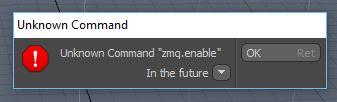

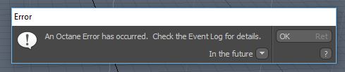

I had to go back to a scene file done in version 801 which I have not run in awhile.
I installed the latest stable version of 3 for modo 801. (Modo801_3_5_3_116)
On start up I get this error
Then I get this error
Then modo crashes.
Do you know whats going on?
Keith

Ok I found the problem
Both the errors and the crash are caused by the "NPRKit v2"
I don't really need it in 801 so it's not a big deal for me.
I have all my plugins installed in custom directories for different versions of modo, so as to not conflict with other versions.
Seems the NPRKit v2 has always been problematic.
Paul let me know if you know of a solution to have both working.
Keith

Hi Paul
Sorry I should of been more clear.
On starting modo 801 it immediately gives me the error " unknown command zmq... etc" then after you click the ok button you then get the octane error and when you click ok again modo crashes.
The NPRKit v2 is made by the foundry as a plug in (kit) for modo that is in your download account. It's for doing cell shaded and sketch type of image effects to the render output.
The errors and then the crash only happen in modo 801.
works fine in 901 and version 10 of modo.
Keith
