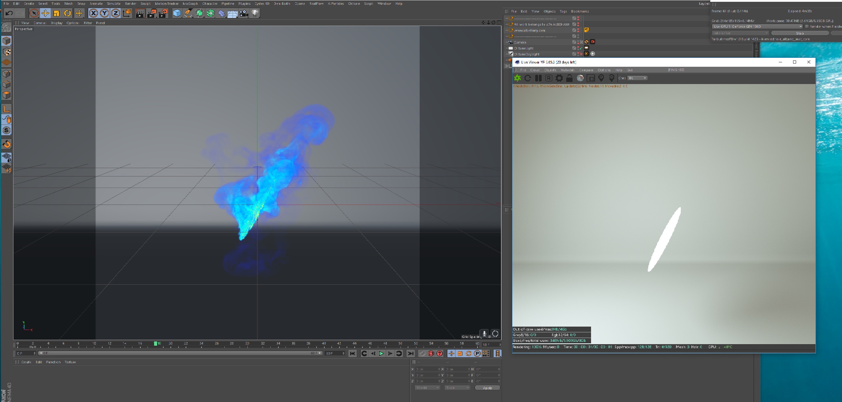

I'm new to Octane and I'm starting to try it with my plugins and I have an issue visualizing TurbulenceFD.
Impossible to see any particles. What am I doing wrong? I heard about the learning version not showing up in the interface, but I have a commercial version.
Is there a tutorial on how to set up OctaneVR and TurbulenceFD so they can speak and I can see some results in Octane window?
Any tip will be helpful,
Thank You!

Yes I have a commercial version.
I tried already made scenes, and I cannot visualize.
I just reinstalled TFD and same problem occurs.
I have C4Dr18, and using PC with two gtx1080

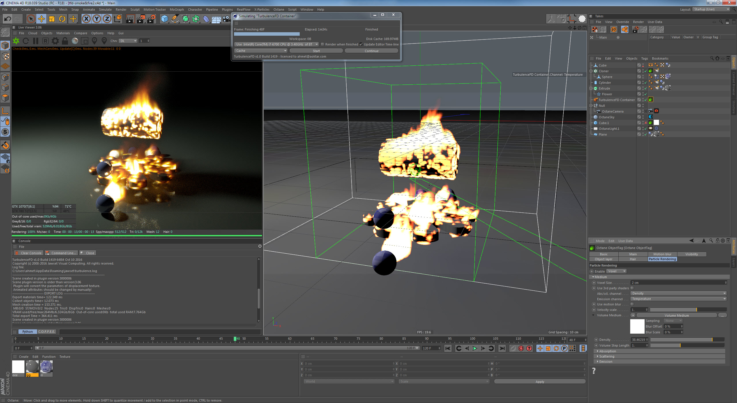

Here is samples package and it has tfd samples. Check octane tag for settings.
viewtopic.php?f=85&t=60816
3MOTION
Posts: 4
Joined: Sat Aug 15, 2015 4:16 pm
Thanks,
also reinstalled OctaneVR now and the sample scenes unfortunately give me the same result.
It works with x-particles and other scenes.
Turbulence still doesn't show up. I'm asking support to Jaweset too.
any other ideas to help me figure out this are apreciated.
Posts: 16068
Location: Türkiye
This is a tested sample. Pls check on your side.
tfd-smoke&fire2.rar
(178.79 KiB) Downloaded 241 times

Thank you so much,
it works.
I knew it was my mistake somewhere and it's because that in the TFD sim window I hadn't "cache" selected.
Thanks again.
