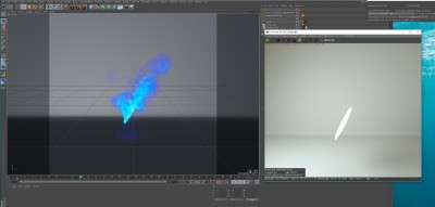

I'm new to Octane and I'm starting to try it with my plugins and I have an issue visualizing TurbulenceFD.
Impossible to see any particles. What am I doing wrong? I heard about the learning version not showing up in the interface, but I have a commercial version.
Is there a tutorial on how to set up OctaneVR and TurbulenceFD so they can speak and I can see some results in Octane window?
Any tip will be helpful,
Thank You!

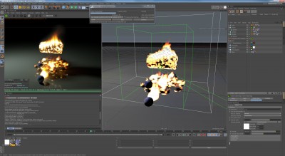

Are you using commercial version of TFD?
Here is samples package and it has tfd samples. Check octane tag for settings.
viewtopic.php?f=85&t=60816

also reinstalled OctaneVR now and the sample scenes unfortunately give me the same result.
It works with x-particles and other scenes.
Turbulence still doesn't show up. I'm asking support to Jaweset too.
any other ideas to help me figure out this are apreciated.
This is a tested sample. Pls check on your side.
