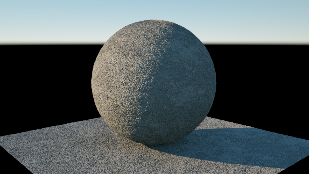

Hey I just did a quick test and was quite surprised to find this works and actually looks pretty good. The texture was put together quick for a friend as he was trying to get it into Cinema and it wasn't working, while I was at it I decided to give it a go in Octane by using the convert material command just for shits and giggles.
I was pretty shocked it worked, I was under the impression Octane didn't have support? Of course the downside is I have no image texture control and I'm assuming it has to do some nasty image export much like with C4D shaders. But all in all looks pretty much the same, even shocked displacement works fine.

aoktar wrote:I don't have any idea how a proper substance convert should be?
I'm talking about the standard convert material within Octane C4D, it seems to work with the conversion of .sbar integration which is native to Cinema. I'm not quite sure what you mean.

Substance does not use MDL.
Substance Designer can generate MDL material files but it has nothing to do with the proprietary Substance file format (sbsar) you can use in C4D.
Substance files generate regular textures using its own engine, Substances are NOT shaders/materials, just textures.
It probably works with Octane in C4D because C4D keeps a bitmap cache of the generated textures.
