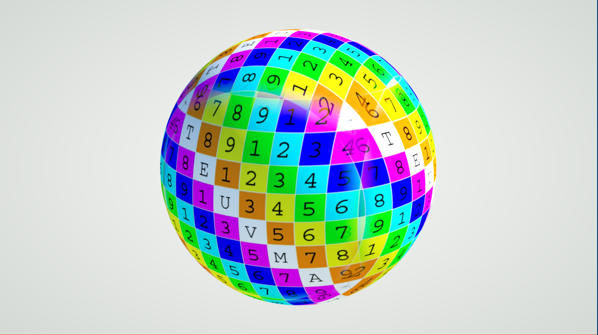

I've attached a sample scene with 2 renders.
It's not that bump doesn't work, it's that it seems like the triplanar projection (connected to diffuse) is sampling the normals after the bump is applied. I could see why this may be useful in some situations but usually I wouldn't expect the texture to change because of the bump. It would be nice if it was an option on the triplanar node and not the default behavior.

I've also done another test where I bake out a triplanar projection. comparing the triplanar projection and the resulting baked texture, in the diffuse channel they look the same. When connected to bump, they behave differently, aside from giving a different bump look, the triplanar requires multiplying the intensity by factors of tens.
OK, yes, I can see the problem now. As you say, it seems an Octane limitation, that is computing the triplanar mapping using the shading normal before it has been perturbed by the bump or normal maps. I'll ask the Octane developers about this feature.

Yes, that seems to be an oversight. The box projection also uses the interpolated geometry normal and not the bump mapped normal. We will change the tri-planar texture node to use the interpolated geometry normal, too, unless there is a very good reason to make it optional, in which case we could make it selectable.WhyGee wrote:Hi,
