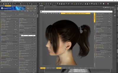

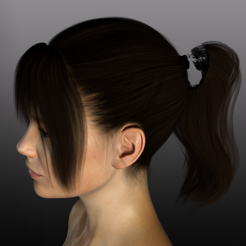

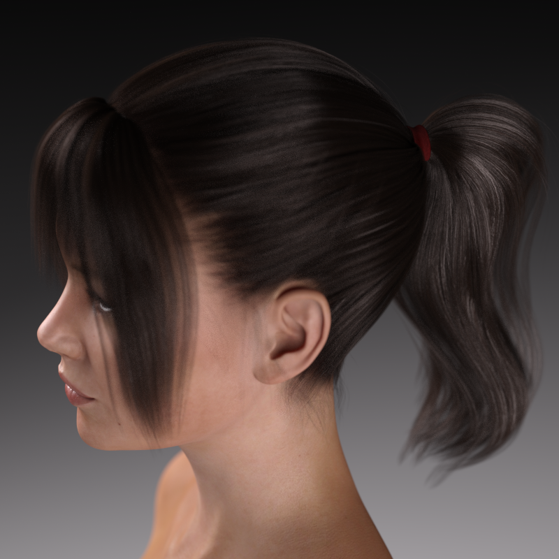

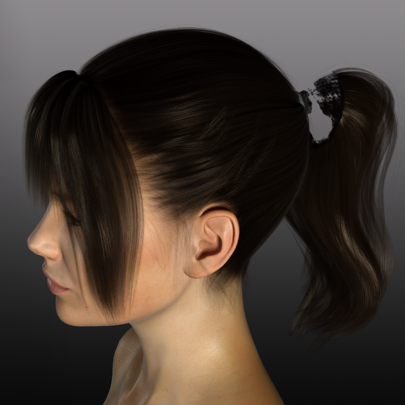

Here is a render of Topmodel Updo Hair and OOT Hairblending 2.0 for Genesis 3 Females from OutOfTouch artist.
I have used and modified all settings without being able to solve the problem.
If you have ever encountered this kind of issue, I hope you can help me.
1st rendering done with Iray shaders.
2nd rendering done with RedSpec specific shaders
3rd rendering done with the Iray engine
Iray Renderer
Iray Renderer
RedSpec shader
RedSpec shader
Default Iray Shaders

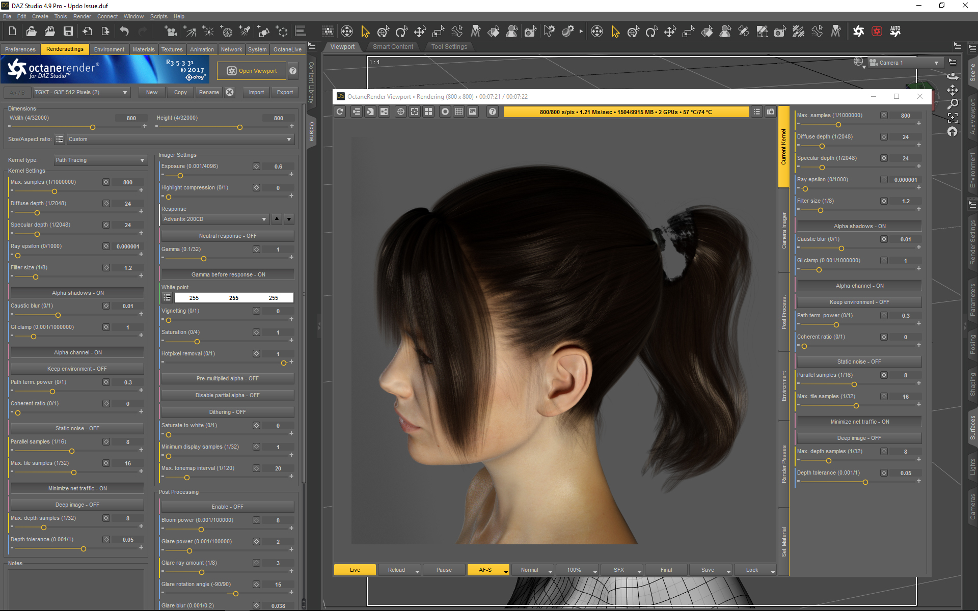

I already tweaked Ray Epsilon to minimum but it doesn't work.
I attached a full screen of my settings
Settings
Settings

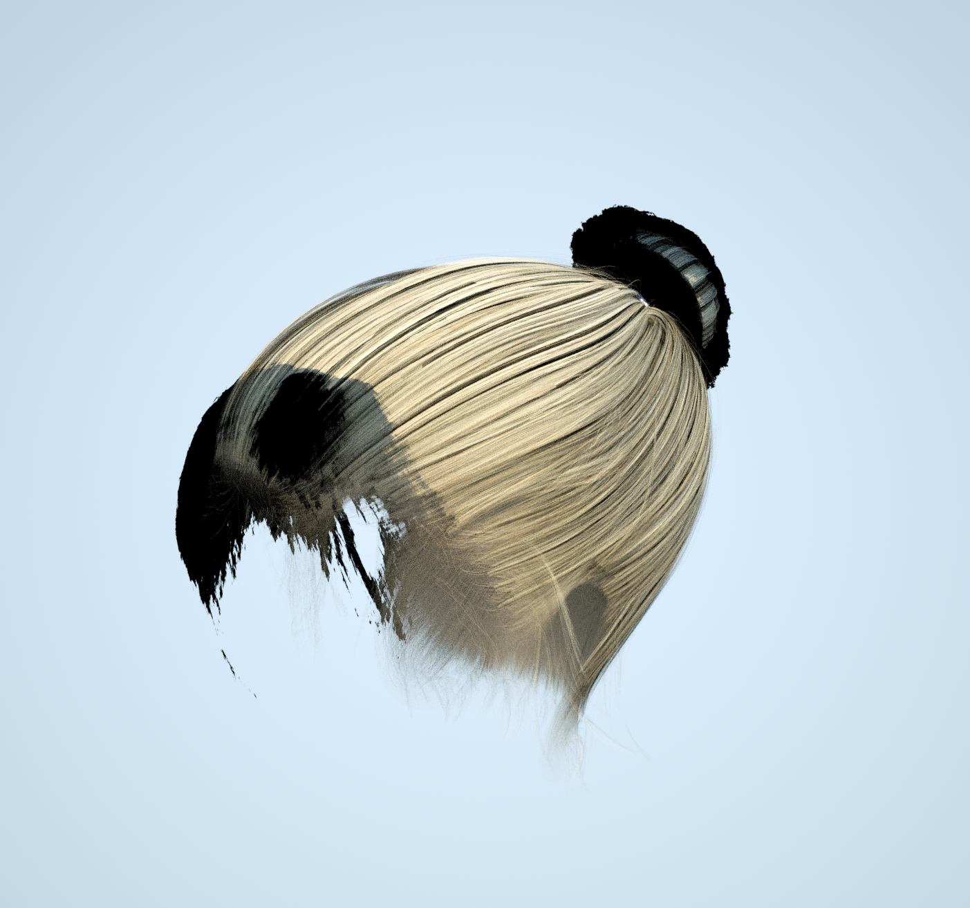

I'm also having a problem with this hair, in fact I think it affects all recent OOT hair with hair blending, but this one is by far the worst, I just have to make parts of them not visible and the black stuff starts to show up. The hair(s) also seem to render extremely slowly, this image only rendered at 0.99Ms/sec using PT.
Rey Epsilon is 0.000001 (auto setting off), changing it doesn't seem to do anything much.

It's not displacement, I get the same thing in clay mode or with a blank white mat. I've also tried it with Iray and Octane standalone, standalone has the black stuff the same as OcDS, Iray is fine and without issue. I've even updated my drivers.
