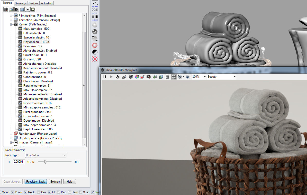

I have imported a mesh model into Rhino. Is there a way for icreasing the smoothness in the octane rendering?
As you can see, in rhino viewport the geometry looks smoother.

Hi - usually high bump intensity in material messes up the normals thus the sharpness.
fabrizio_s
Posts: 345
Joined: Fri Feb 03, 2017 12:14 pm
Hi Formatio,
yes, it could be a way but as you can see rhino render is better than Octane render so..probably there is some parameter in Octane to adjust.
thanks
fabrizio

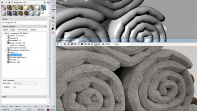

I just noticed there is a Displacement in your material in the screenshot above. That is probably causing the fine details you are seeing on the towel.
Paul
