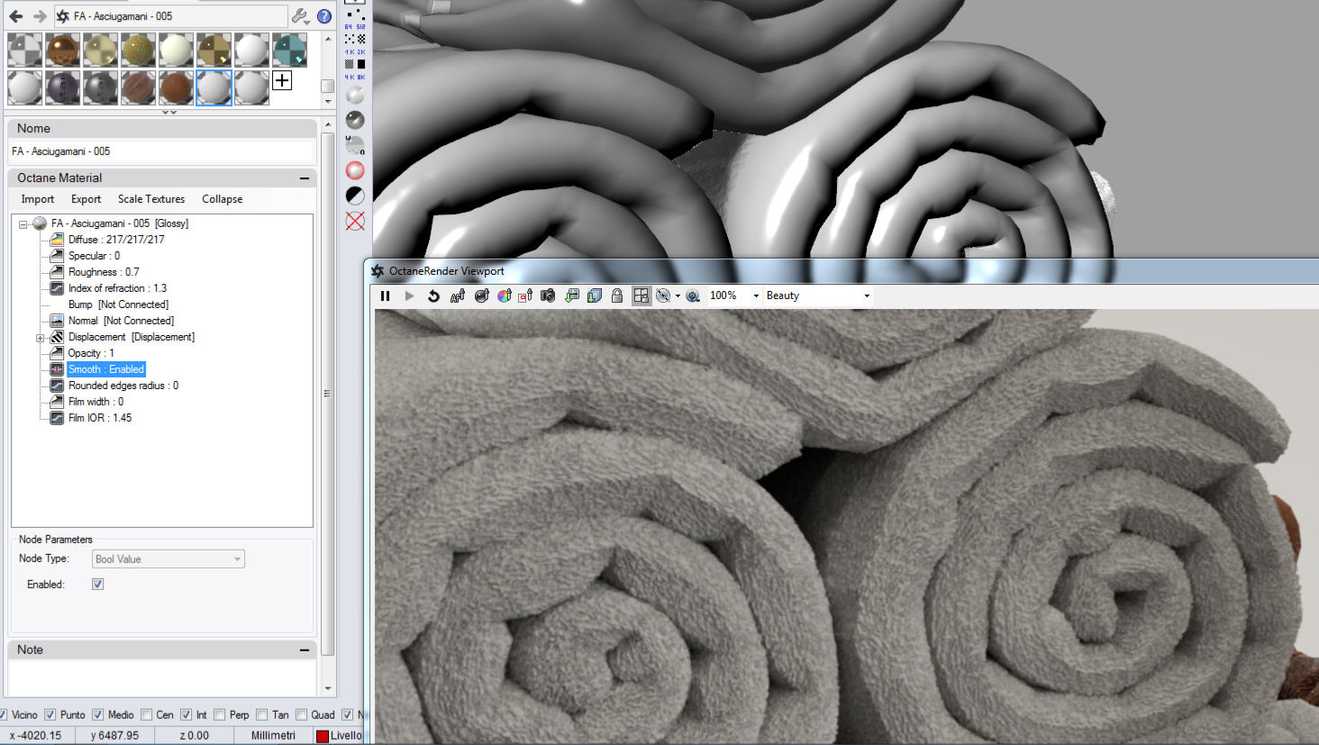

I have imported a mesh model into Rhino. Is there a way for icreasing the smoothness in the octane rendering?
As you can see, in  rhino viewport the geometry looks smoother.
							Smooth geometry

Hi - usually high bump intensity in material messes up the normals thus the sharpness.

Hi Formatio,
yes, it could be a way but as you can see rhino render is better than Octane render so..probably there is some parameter in Octane to adjust.
thanks
fabrizio

Can you send me that mesh pls, and I will take a closer look.

I just noticed there is a Displacement in your material in the screenshot above.  That is probably causing the fine details you are seeing on the towel.
