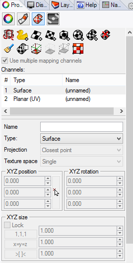

there are two channels(surface and planar) visible in the object properties. (planar is 45° rotated so that channel should render visually differently when using stripes,squares and such)
If I start the render, and the go into the UV projection properties of the diffuse texture, and set it to UV set "2" i do not see the 45° rotated diffuse map, but only a single colour.

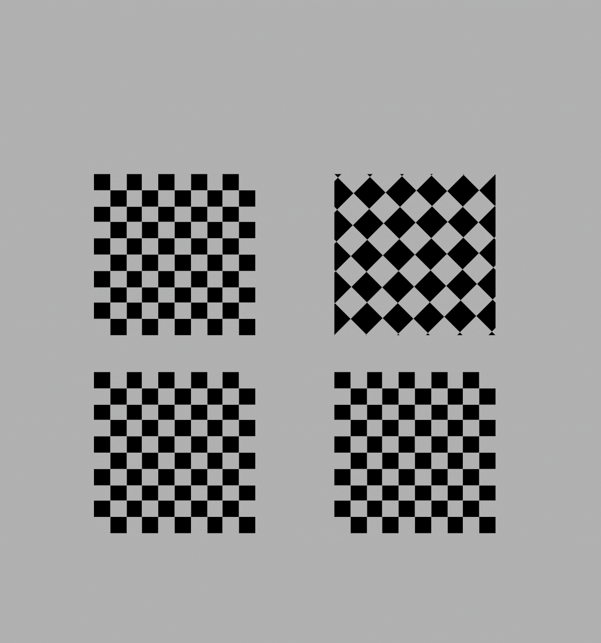

deeKay
Posts: 19
Joined: Wed May 12, 2010 4:05 pm
file attatched!
mapping channel setup of all the planes is identical, only materials differ
below is a rhino render
right column uses channel 2 for displaying the diffuse map
left column uses channel 1 to display the diffuse map
here you see it all in one picture,
so the following things can be observed:
A- if a rhino material uses channel 2 and is rendered via octane it renders like using channel 1
B- if a octane material uses channel 2 and is rendered via octane it renders the average colour of the map
C- Octane open GL preview does not seem to take account of the UV set setting, and displays the map like channel 1
other render engine directly from rhino: (of course the octane material won't be picked up correctly, but the top row with rhino materials works as expected)
mappingChannelBug.zip
(36.6 KiB) Downloaded 333 times
